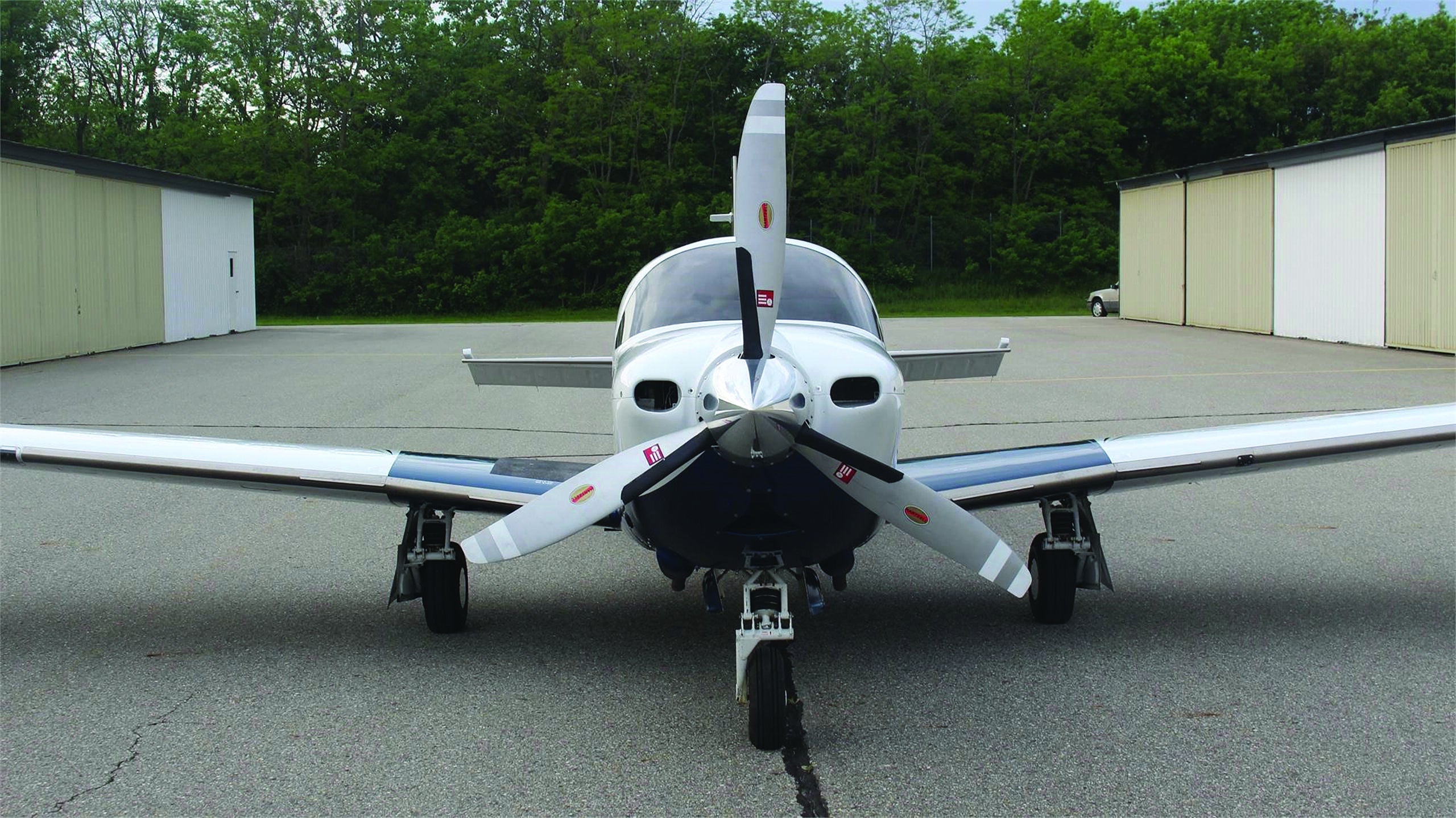

Aircraft Profile: 2000 Mooney M20S Eagle
OEM Engine: Continental IO-550-G
Empty Weight: 2229 lbs.
Maximum Gross Takeoff Weight: 3200 lbs.
Typical Cruise Speed: 170 KTAS
Standard Fuel Capacity: 75 gal.
Service Ceiling: 21,000 ft.
Range: 856 NM
VS0: 58 KCAS
