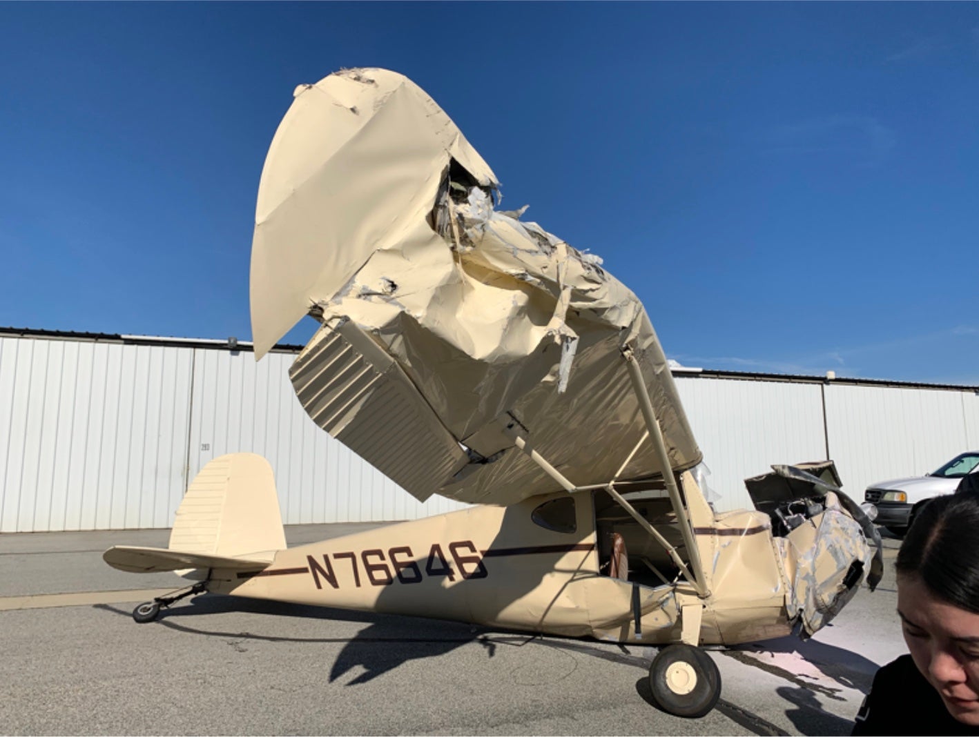

Circling back to luck is the video we’re running this week of an accident that occurred at California’s Cable Airport in January 2022. The lucky part accrues from the fact that any pilot who finds himself in a 90-degree bank at 30 feet with no roll control survives at the whims of gravity and flat dirt that’s not too hard. (The video was posted by Aviation Safety Network.)
The particulars of the accident are that the pilot of a Cessna 120 approached Cable’s Runway 24. On short final, he encountered rotor wash from a Huey helicopter operated by the local sheriff’s department that caused an uncontrolled roll to the right at low altitude. The airplane struck in that attitude—nose first—and pirouetted into a slide that just missed the end of a hangar block. The pilot sustained minor injuries, but the airplane was seriously trashed.
I read a lot of accident reports and about one in 50 turn out to be, well, really interesting. This one was one of those, by dint of the pilot having attached his own detailed analysis and statement of what happened that lends far more detail than the NTSB’s minimal analysis. In toto, with the pilot’s report, it’s possible to learn something from this; without it, not so much.
If the pilot’s statement was accurate, there were two helicopters operating at the airport, neither of which observed recommended procedures for the airport. One of the helos crossed in front of the Cessna without announcing its intentions, according to the pilot’s report. He was in the midst of applying go-around power when he encountered the rotor wash and lost control.
