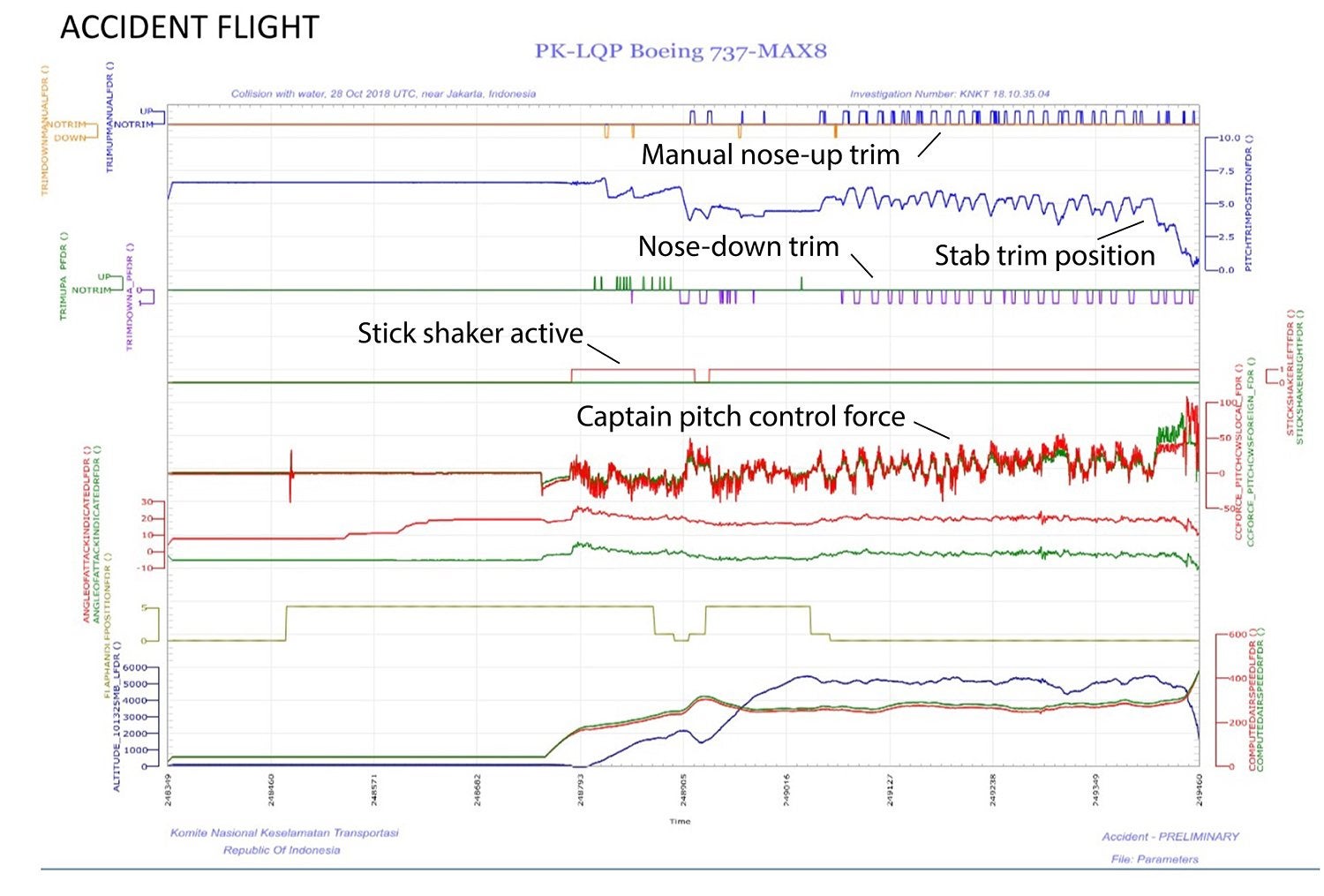

While NTSC awaits the arrival of a specialized ship to continue its search for the aircraft's cockpit voice recorder, data from the recovered flight data recorder revealed that the pilots struggled to maintain consistent pitch, speed and altitude throughout the 11-minute accident flight. The data trace released by the safety agency showed that faulty AoA indications activated the left-side stick shaker almost continuously shortly after takeoff.
The faulty AoA indication also invoked an automatic background trim system Boeing installed on the MAX series called MCAS, for maneuvering characteristics augmentation system, according to the FDR data. Because the MAX aircraft have heavier engines, the center of gravity is biased more forward than on previous models and MCAS is intended to improve pitch feel and provide stall protection. It activates automatically in manual, flaps-up flight at high angles of attack and high load factors, adding nose-down stabilizer trim at a rate of 0.27 degrees per second to a maximum of 2.5 degrees. MCAS will continue to add nose-down trim until the high AoA is resolved.
The system can be temporarily defeated by trimming against it using the yoke-mounted trim switches. But it will resume nose-down trimming after five seconds. The 737 series is equipped with stabilizer trim cutout switches and if activated, the airplane's electric stabilizer trim is disabled, which also disables MCAS.
The crew that experienced similar problems on the previous day's flight did use the trim cutout switches, the NTSC said. Because the CVR hasn't been found, it's unclear why the accident crew didn't do the same. "We need to know what was the pilot discussion during the flight. What was the problem that may [be] heard on the CVR. So why the action difference, this is the thing we need to find. At the moment I don't have the answer," said the NTSC's Utomo.
Released flight data shows that flight JT610 flew an inconsistent flight path characterized by pitch, altitude and vertical speed excursions. The captain's stick shaker activated shortly after takeoff and remained almost continuously active. The captain appears to have used manual nose-up electric trim against MCAS's nose-down trim at least 30 times, according to the FDR data. Nose-down yoke forces appeared to have peaked at just over 100 pounds.
