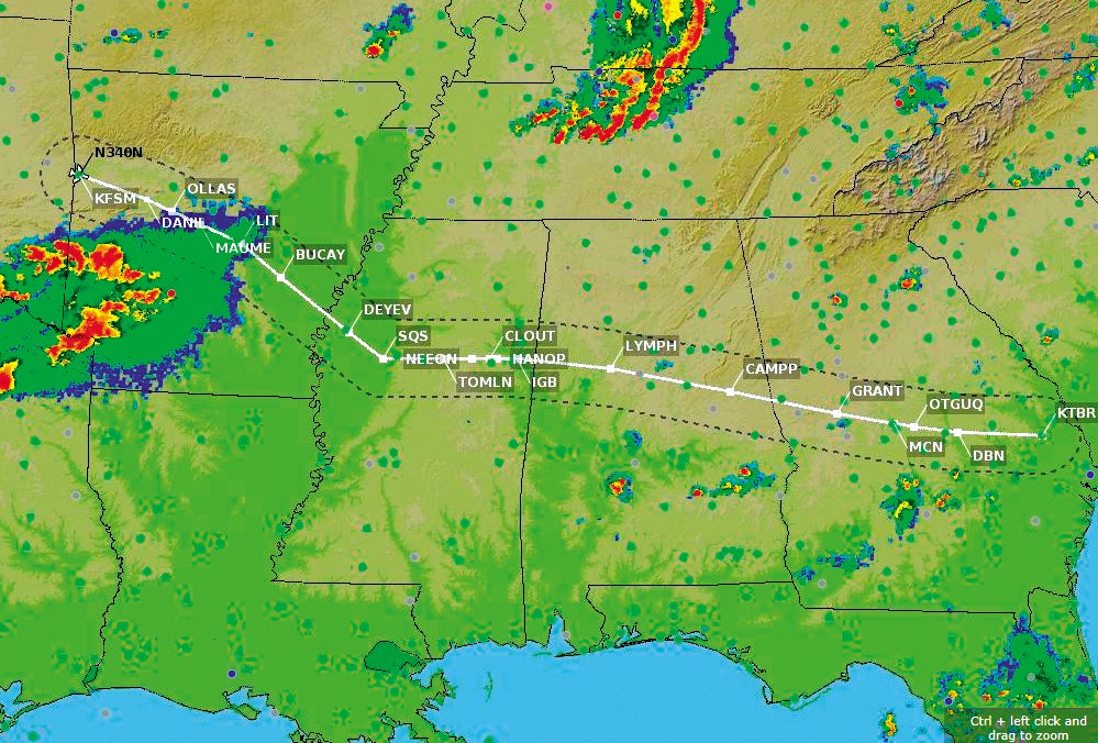

Start with “Adverse Conditions.” It maps your route. Below the map by “Wx” select the weather views you want. Loop the weather by clicking “Animate Wx” after having chosen a view. Click “Configure Map” to select map features you wish to see. Left‑click and drag to move the map. The mouse scroll wheel or “+” and “–” buttons at the top zoom in or out. TFRs are automatically shown in text and as blue rectangles on the map including estimated times of entry and exit along your route. This NEXTGEN feature is used in several map displays as for AIRMETs and SIGMETs.
With “Adverse Conditions” still selected, explore the items on the subtab lines. If the AIRMET(s) mention IFR conditions, a third IFR subtab line will be created to address relevant conditions in an AIRMET SIERRA (IFR conditions), AIRMET ZULU (for icing) or AIRMET TANGO (for turbulence).
