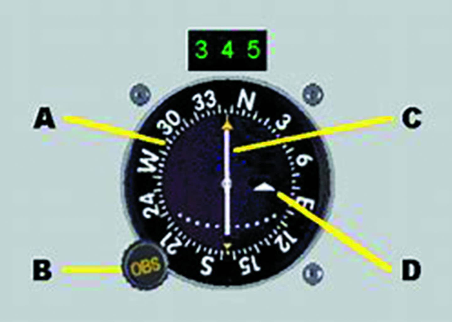

A Piper Arrow was on a VFR flight when its GPS failed. In-flight troubleshooting also failed. The pilot elected to land and correct the issue. Spotting an airport with two runways, but unable to identify it, the pilot landed.
After parking, the pilot noticed many people in uniform. After speaking with a police officer, he found he had been in a restricted area and worse, he had landed at a military base. The pilot's idea of resolution centered on his instructor's post-event recommendation to shut all the avionics off and restart. He added that he should have requested flight following through the area.
Somehow this instrument-rated pilot managed to forget that his Arrow had two VORs, which he could have used to locate himself. This may be a dying art, but it works. A much better idea than time in the brig.

Even better, he could have used his GPS to verify that he was landing at KVAY. The VFR Sectional reveals a cluster of four airports in the vicinity. Many pilots use OBS mode to set the centerline of the desired runway or enable the runway extension feature in many MFDs to prevent this kind of error.
