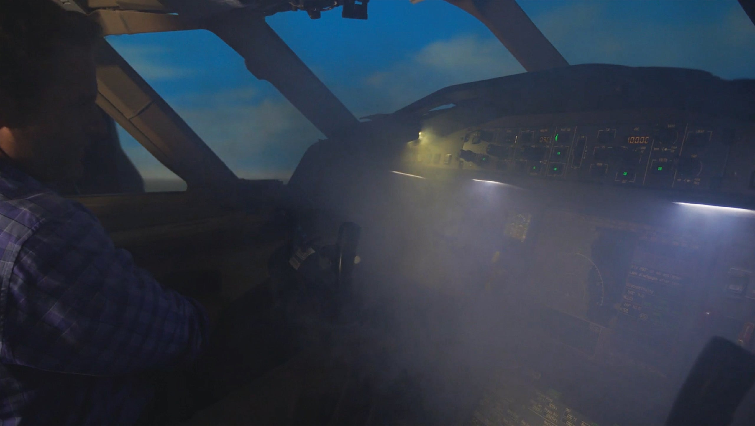

The smoke goggles were not needed because this was an oil-based smoke and there was very little eye irritation. Had this been an electrical fire, the goggles provided would have been nearly useless. They do not seal, so smoke would be trapped inside the goggles, and they are not stored in a convenient location if required immediately. I will be using a pair of sealable swim goggles and have them readily available in the future. I’ll also frequently practice using the oxygen mask, goggles and headset to the point of complete proficiency.

Since this event, I have been made aware of a system called EVAS (Emergency Vision Assurance System), produced by VisionSafe for a variety of aircraft, mostly Part 25 transports and business jets. I was able to visit the company, try the system and understand how it is used and operates. I’m convinced having EVAS would have minimized our reliance on luck, as discussed in this article.
