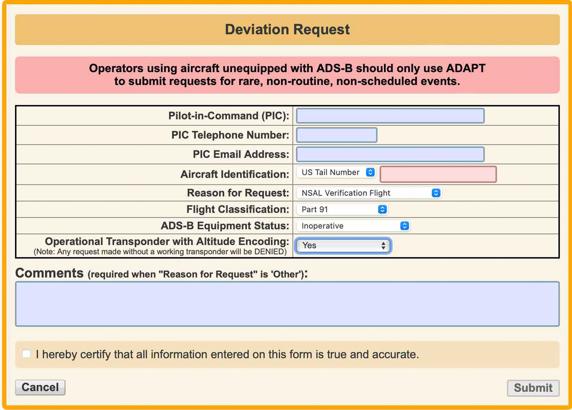

You don’t want to be IFR in ADS-B airspace with faulty equipment. If the FAA notifies you of the situation, you can use the agency’s online ADAPT deviation request form, bottom photo, to fly to the shop for repair.

If you discover your ADS-B Out system is noncompliant, your aircraft isn’t automatically grounded. However, you do need to obtain authorization to fly in airspace that requires ADS-B Out. The process is straightforward and takes just a few minutes:
Go to the FAA’s ADAPT website and fill out the flight entry form. In Box 11, select “inoperative” for the first two options and “N/A” for the last. In the “Reason for Request” section, chose “NSAL verification flight.” Once submitted, the request will usually be automatically approved.
The FAA ADS-B team is incredibly helpful, and you can always reach out to them at adsbfocusteam@faa.gov or adapthelp@faa.gov. They’ll provide guidance and support, whether it’s via email or a phone call.
If your aircraft ends up on the NSAL list, don’t panic—it’s simple to get it removed. Send your avionics shop a PAPR report. File a deviation flight request and get approval on the FAA ADAPT website and then fly for 30 minutes in ADS-B airspace. Pull another PAPR to confirm the ADS-B system is now compliant and send it to the FAA’s ADS-B team. Once they receive the updated report, they’ll remove you from the NSAL list. It may take some time (they meet once a month), but keep filing the deviation requests until you’re removed from the list.

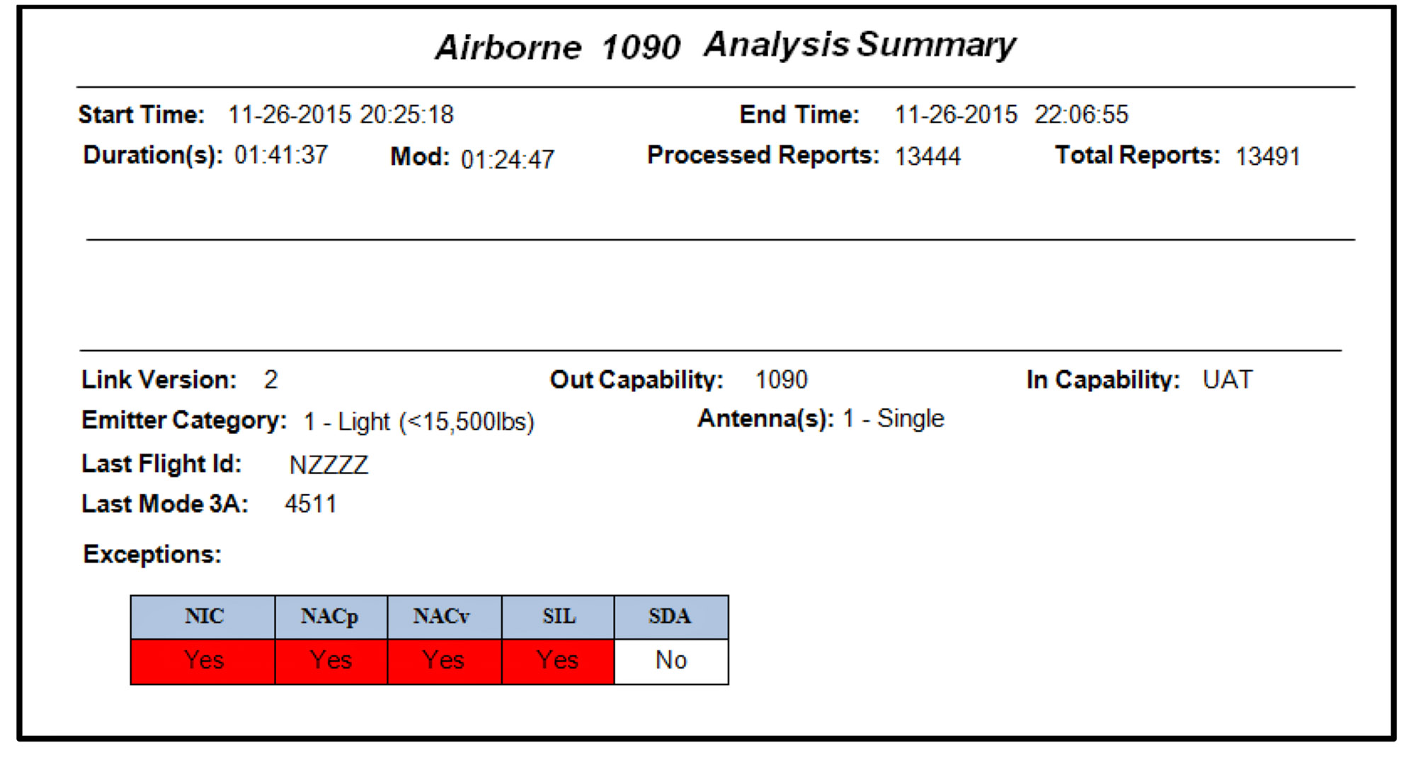

You went flying and got an FAA Public ADS-B Performance Report  (PAPR) and it shows the system in your aircraft has one or more faults. In other words, it flunked. In most cases, you’ll need to visit a qualified shop to sort it out, but a good place to start the troubleshooting is with the FAA’s PAPR User’s Guide.
This guide is especially helpful because it describes—in plain language—what some of the fault codes might be that show up on a flight test report. The screen grab below is one analysis summary table of a 1090 ADS-B Out transponder. The Start Time, End Time and Duration fields obviously refer to the time of the flight as observed by ground monitoring. Processed Reports are the number of reports that were processed by the ADS-B ground station. Link Version indicates which standard (1090 MHz or 978 UAT) the installed equipment complies with, plus any ADS-B In capability. It even knows how many antennas are installed on the aircraft.
The Exceptions field from the example below shows four specific failures in attention-getting red shaded boxes—essentially indicating that the aircraft’s ADS-B out data failed to meet performance requirements. In these reports the FAA assesses equipment performance in four major categories, including any missing elements that are required in the ADS-B Out broadcast, integrity and accuracy (NIC/NACp/NACv/SIL/SDA), kinematics (the aircraft’s changes in baro and geo altitude, velocity and horizontal position), plus other checks that include the proper formatted 24-bit ICAO address and other configuration settings.
Remember that while the physical installation of any ADS-B system is integral to performance (including antenna placement and proper input of a compatible external WAAS GPS, if it’s not self-contained in the ADS-B system), performance relies heavily on the installer getting the configuration correct. That doesn’t always happen and might generally result in a NIC, NACP, NACv, SIL or SDA failure. But the same is true for loss of GPS position, which can be a symptom of antenna shadowing caused by maneuvering. An altitude encoder (Mode C) problem could fail the baro altitude data, while loss of geometric altitude data from the GPS will fail the geo altitude data.
The point is to work closely with your shop by presenting them with the last PAPR report, while also working with the FAA representative identified in the NPE (Non-Performing Equipment) letter if you get one. Once you get the system fixed, they will remove the aircraft from the NSAL.
