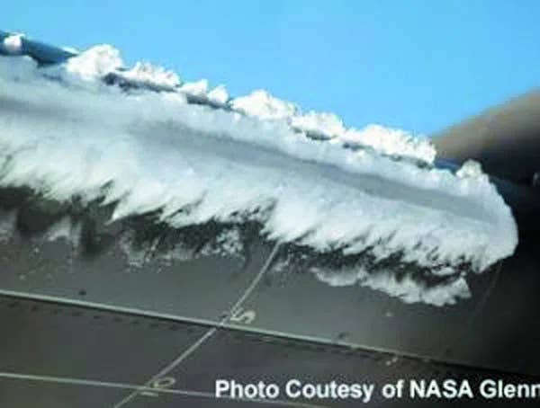

Mixed icing on a wing leading edge with “horns” just starting to develop – significantly increasing drag and stall speed. Image: NASA
