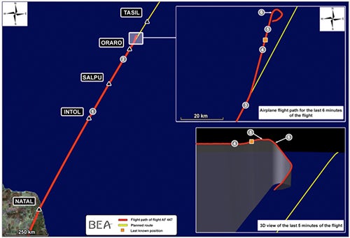

As the captain entered the cockpit, the aircraft's systems received airspeed values they deemed invalid, leading the airplane's systems to automatically shut off the stall warnings. The aircraft was still in full stall with the nose up, falling at -10,000 ft/min. Almost one minute into the stall, the pilots reduced engine thrust and temporarily made nose-down inputs that were not enough to break the stall. As the jet continued to fall, it rolled at times up to 40 degrees and turned more than 180 degrees to the right. Data shows that the pilot flying held the sidestick at the full left and nose-up stops for the entirety of one 30-second span, and that the airliner remained stalled until impact.
There were as many as three pilots in the cockpit through the majority of the descent. The pilot flying as the event unfolded was the least experienced of the crew, with 3,000 hours of flight time. He was right-seat at the time. The flight's captain had almost 11,000 hours of experience. He was not in the cockpit as the incident began. The cockpit crew attempted to call him to the flight deck several times during the first minute after the airspeed sensors failed. He joined them less than two minutes after the autopilot disconnected. A second pilot, flying left seat, was given the controls in the flight's final minute. Aside from that information, BEA, the investigating agency, did not publish any cockpit conversation that took place during the last minute of the flight.
The aircraft impacted the water at 16.2 degrees nose-up with a roll angle of 5.3 degrees to the left. The aircraft heading was 270 degrees (nearly opposite the planned route of flight) and the ground speed was 107 knots. The last recorded vertical speed was -10,912 ft/min.
