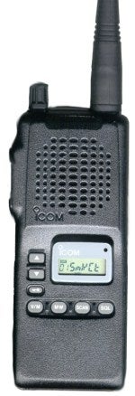

Smaller size, fewer controls...

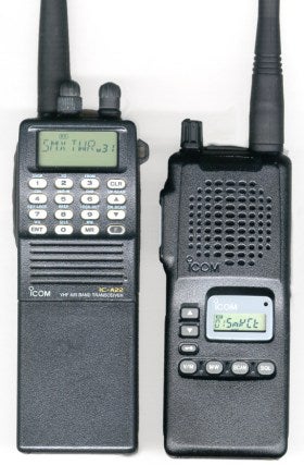

As you can see in the photo atright, the A4 is a bit less tall than its more-expensive siblings (5 1/2" versus 63/4"); width and depth are about the same. ICOM says the A4 is "small enough tofit into a pocket" and that's true...provided you have a big pocket and you ignorethe "rubber duckie" antenna.
The A4's antenna is 8" high, nearly one and a half times the height of the radioitself. The visual effect is definitely one of "the tail wagging the dog." Withtheir antennas installed, the A4 is almost exactly the same height as the A3/A22. So whilethe A3/A22 was dramatically smaller than its predecessors, the A4 isn't really smallerthan the A3/A22 in any truly meaningful way.
More significant than the size difference is the A4's much-reduced compliment ofcontrols. While the A3/A22 sports 18 keys, three knobs plus the push-to-talk bar, the A4has just 7 keys and one knob plus PTT. The reduction in buttons and knobs was a majorcost-saving factor in the design of the A4. However, since the A4 supports most of thefunctions of the A3 with only a third as many controls, many of the keys wind up doingdouble or triple duty. This makes the A4's user interface somewhat less intuitive and moredifficult to learn. At least it was for me. In fairness, ICOM's user manual is very clear,and a small quick-reference card is also included with the A4.
The A3/A22 tuning andsquelch knobs are gone, their functions replaced in the A4 with digital controls. Tuningis accomplished by pressing and holding the up- or down-arrow key until the digitalfrequency display has slewed to the desired frequency. While this works, I found it quiteawkward (and slow!) compared to using the tuning knob or the direct-entry keypad on theA3/A22. This awkward tuning is one of the most serious drawbacks of the A4's design, in myopinion...we'll get to the others shortly.
Adjusting the squelch on the A4 is accomplished by holding down the SQL key while usingthe up- or down-arrow key...I found this quite adequate, especially since squelchadjustment isn't needed all that often.

ICOM also economized on theA4's LCD display. As you can see from the photos of the two displays (A4 above, A3/A22right), the A4's display has only about 25% of the area as the one on the A3/A22.
The A4's display is very crisp, well backlit, and entirely adequate for numeric displaypurposes. Its shortcomings become apparent, however, when displaying alphabeticinformation. The A3/A22 display employs 12 segments per character, making it very legiblein alphabetic mode. The A4 display, on the other hand, has just 8 segments per character,resulting in alphabetic characters that range from ugly to indecipherable. Someletters appear as uppercase, others as lowercase, and a few as nearly-unrecognizablehieroglyphics. For example, compare the labels for my home airport control towerfrequency: a very clear "SMX TWR" on the A3/A22, versus a barely-legible"SmXCt" on the A4...ahem!
