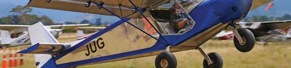

This early example of a STOL CH 701 (left) has seen many demo flights and still looks good. The first CH 750 SD factory demonstrator (right) is the ultimate development of the Zenith STOL series.
