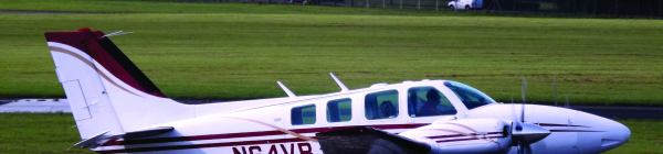

Not accident aircraft. Photo: James/Flickr

Aircraft Profile: Beechcraft Model 58 Baron
OEM Engines: Continental IO-550-C
Empty Weight: 3443 lbs.
Maximum Gross Takeoff Weight: 5500 lbs.
Typical Cruise Speed: 195 KTAS
Standard Fuel Capacity: 136 gal.
Service Ceiling: 20,688 feet
Range: 1109 NM
VS0: 74 KCAS
