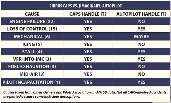

So I decided to compare the would-be capability of the autonomous panic button with the Cirrus-type CAPS I wrote about in the previous blog. One thing is obvious at the outset. Ideally, this shouldn't be either/or but both. You'd want the autonomous autopilot as your first choice, the parachute as your second. That's not, by the way, what Cirrus is doing with the CAPS in the SF50 jet. The autopilot will have sufficient autonomy to manhandle the airplane into the CAPS envelope before allowing it to deploy. It won't have autonomous landing capability, at least initially.
Using the Cirrus CAPS "saves" as a baseline, the chart above shows a summary. I sorted these into nine broad categories and asked myself: How would the smart autopilot have handled this compared to the parachute? The answer is generally not very well. I gave the AP all the stalls and loss-of-control accidents, plus the pilot incapacitation. But it's not going to be much help with engine failure unless an airport is handy and I'm not so sanguine as that. Maybe it could handle other mechanicals such as the control failures, but I doubt it.
VFR into IMC? Yeah, the autopilot gets that one. But it loses on the midairs, unless it has algorithms for flying with pieces of the airplane missing or a Skyhawk as a hood ornament. Of course, in the brave new autonomous world, there won't be midairs. Fuel exhaustion is a toss-up, but only because the smart autopilot may be part of a sophisticated system that wouldn't let you take off or would assume control in a critical fuel situation, like configuration protection in airliners. On second thought, forget it: The parachute is better in those circumstances.
Really, the BRS works in almost all of the abnormals listed here. It doesn't work in low-altitude upsets, but perhaps the autopilot wouldn't either. It doesn't work in high-speed loss of control and maybe the autopilot, given sufficiently muscular and smart servos, could withdraw the fat from the fire in that case.
