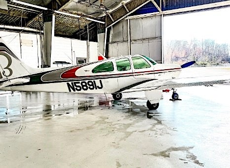

Image from Jenny Blalock's Instagram post.
  • A high-performance Beechcraft Debonair crash, killing pilot Jenny Blalock and her father, is suspected to have stemmed from the aircraft's elevator trim being set to a radical 5-degree nose-down position.
