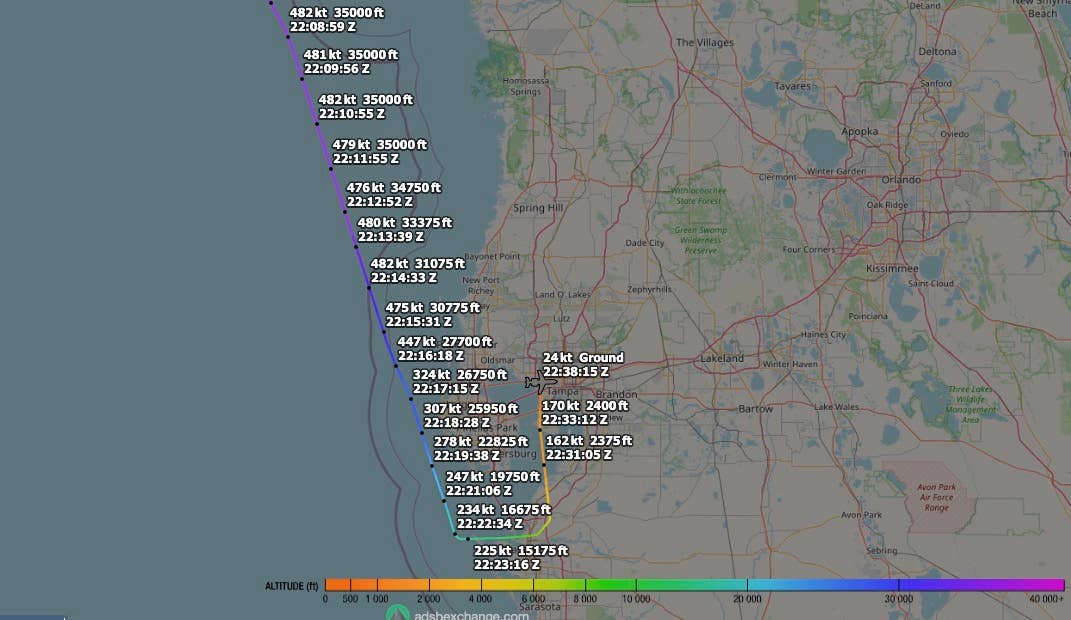

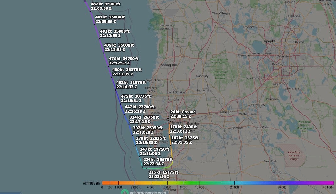

According to a Tamarack Aerospace statement, the single pilot (the aircraft’s only occupant) experienced “bumps” at 27,000 feet on descent from 35,000 feet to landing at Tampa International Airport (KTPA) on the early evening of March 30. The pilot then noticed that the winglet was missing and declared an emergency. “He followed standard procedure and slowed the aircraft while making a smooth approach and landing,” according to the statement.
Data posted by ADS-B Exchange shows the Citation beginning its descent from 35,000 feet off the west coast of Florida, taking about four minutes to reach 27,000 feet, where the separation reportedly occurred. The descent rate was normal for a CJ3 at approximately 1,925 feet per minute. The rest of the descent to landing about 20 minutes later also shows normal performance. According to Tamarack, the modified Citation is one of three active-winglet-equipped Citations operated by the owner, who asked not to be identified. “The owner and pilot are talking with authorities, and further investigation will be conducted to assess possible damage to other areas of the aircraft before repairing the left wingtip and returning the aircraft to service,” said Tamarack.
