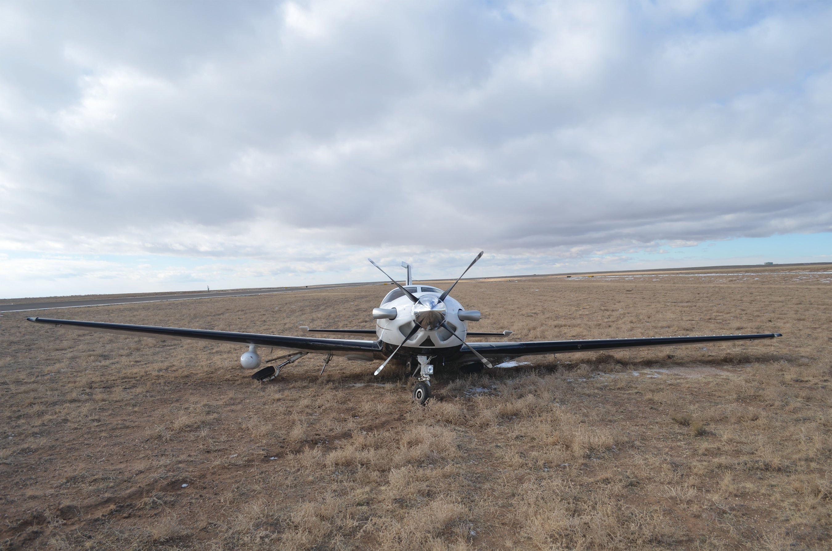

This Piper turboprop single came to rest with little to no propeller damage. Its pilot had a wide-open field with short vegetation and few obstacles with which to work, but still pranged the landing gear.
