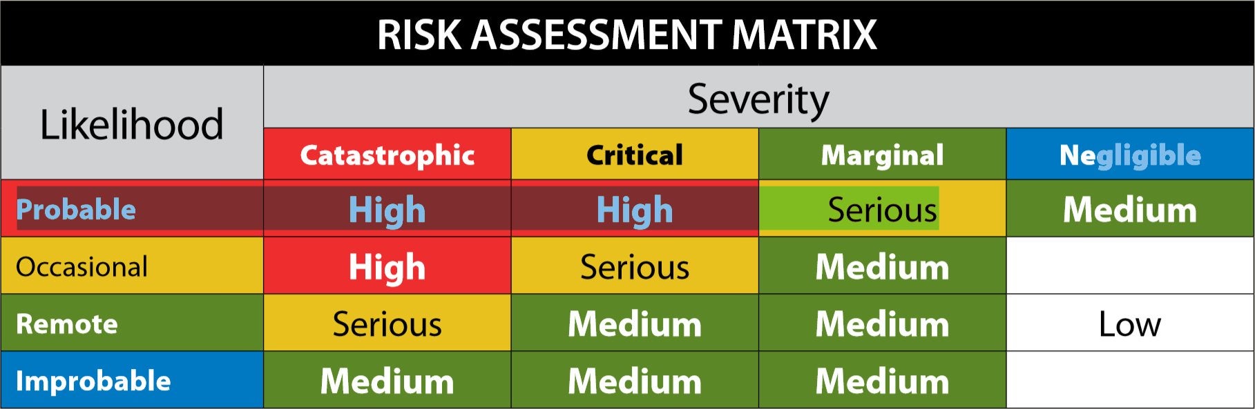

Our basic strategy to managing the risk of engine failure starts with our familiar risk management matrix, reproduced at the top of the following page. Once a risk is identified—engine failure in this case—we must analyze it in terms of its likelihood (probability) and its severity (consequences). This will allow us to see the total risk and then point the way to mitigating actions. The objective is to mitigate unacceptably high risks down to lower risk by reducing risk likelihood and/or severity.
What’s an unacceptably high risk? Any high risk (red) must be mitigated to lower either the likelihood or the severity of the risk to produce a lower overall risk level. What if the risk is “merely” at the serious (yellow) level? Good practice and professional standards dictate that this risk also be mitigated. If you look at any airline or corporate flight department, you will find that risk management is ingrained in both aircraft certification standards and operating procedures such that most risks end up being mitigated to the low (white) level. You should always be striving to reduce risk, but as a general aviation pilot you have discretion to accept some risks that our commercial cousins always mitigate.
Managing Risk Likelihood
Let’s start by analyzing how we can manage risk likelihood for engine failures. An engine failure in a single-engine piston aircraft, while unlikely, is still possible, so the likelihood is firmly in the “remote” line. An engine failure in a turbine-engine single, on the other hand is highly unlikely to occur, hence “improbable.”
Does this mean that you can’t control risk likelihood in your piston single? No. Obviously, you can move the severity needle anywhere within the “remote” bucket so that you are closer to the “improbable” category than you are to the “occasional” level.

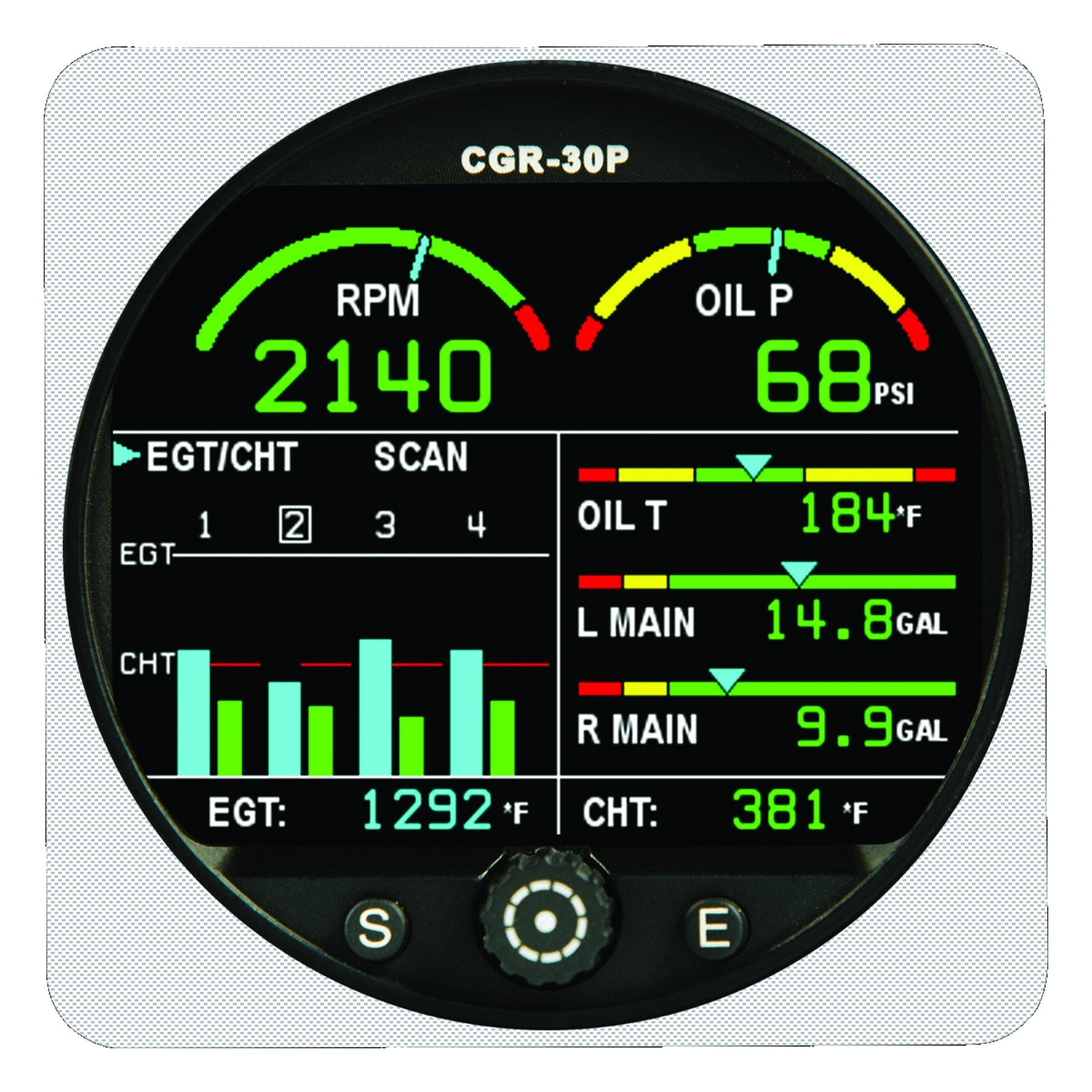

Engine monitoring. Think seriously about having one in your aircraft and using it to evaluate the health of your cylinders and valve train.
Other engine instruments. Even rudimentary engine instruments can be used to detect changes and trends. Is your oil pressure lower than normal and your oil temperature higher? Time to ground the aircraft and investigate.

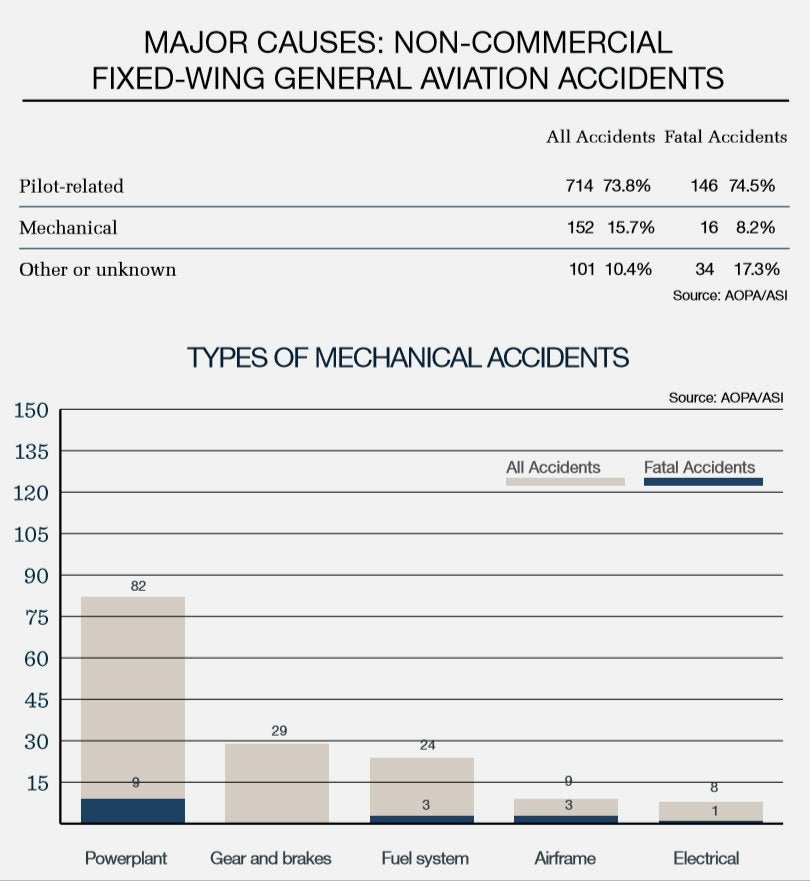

The Aircraft Owners and Pilots Association (AOPA) Air Safety Institute (ASI) recently published its latest annual Nall Report, analyzing fatal and non-fatal general aviation accidents. The 2018 Nall Report looks at NTSB data beginning with 2006 through 2015. It breaks down accident causes into three major categories: pilot-related, mechanical and other or unknown (top right). The data shown are for 2015 alone.
In 2015, mechanical reasons were ascribed to 15.7 percent of non-commercial fixed-wing accidents, earning them a distant second behind the pilot-related category. Of them, 82 (54 percent) involved the powerplant. Only nine (11 percent) of the powerplant failures during 2015 were fatal, meaning we basically have a one-in-ten chance to survive an accident resulting from an engine failure. As this article’s main text explains, however, some unknown number of engine failures do not result in a reportable accident.
Risk Assessment Matrix
Risk assessment matrix
Likelihood
Probable: An event will occur several times.
Occasional: An event will probably occur sometime.
Remote: An event is unlikely to occur but is possible.
Improbable: An event is highly unlikely to occur.
For ease of analysis, the risk assessment matrix has only four “buckets” of likelihood or severity. In reality, an event’s outcome occupies a continuum of infinite levels of both likelihood and severity.
Severity
Catastrophic: Results in fatalities or total airframe loss.
Critical: Severe injury or major damage.
Marginal: Minor injury or minor damage.
Negligible: Less than minor injury and less than minor system damage.
