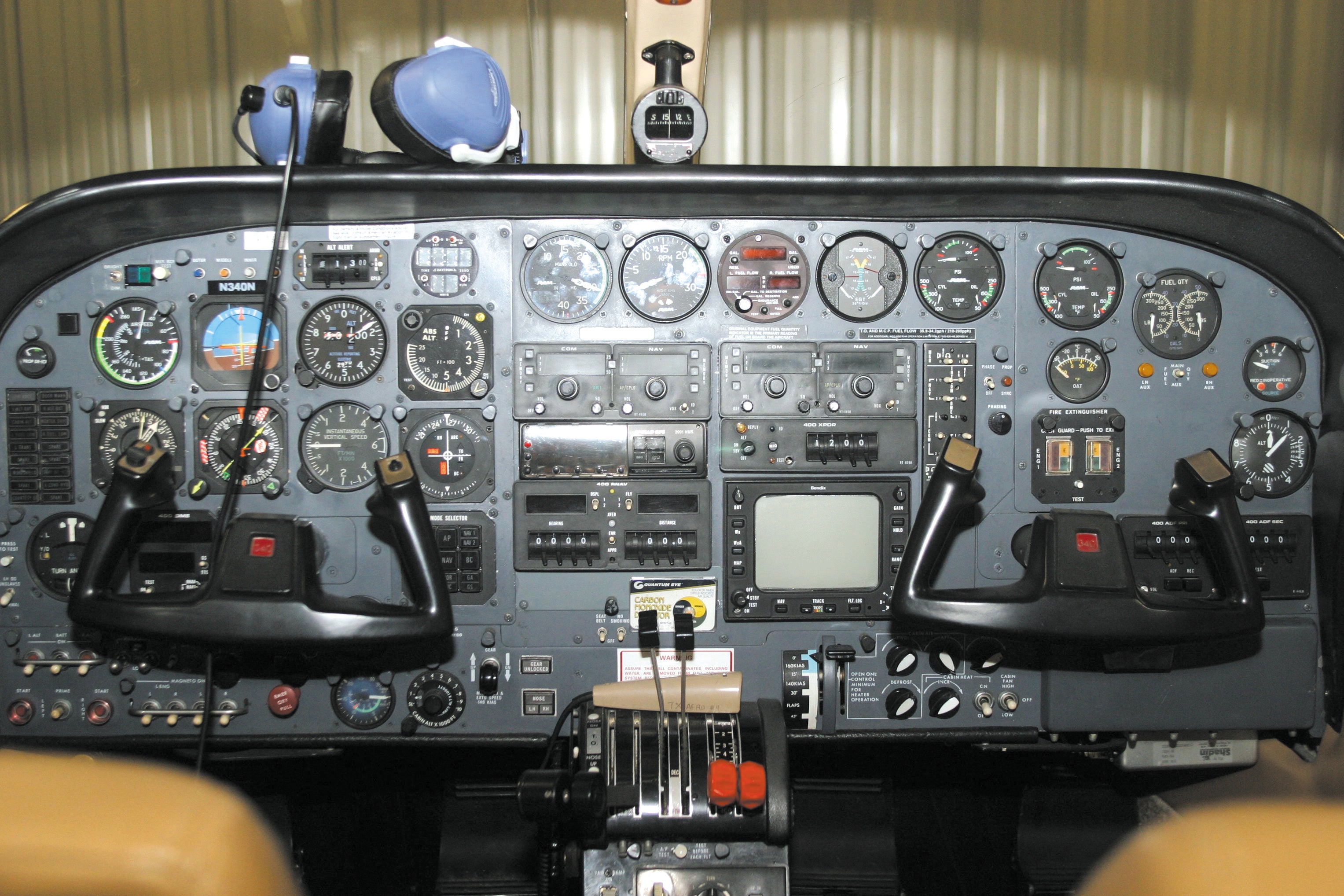

The original panel was upgraded about eight years ago.

About eight years ago, I undertook a significant avionics upgrade. Before that my 1982 Cessna 340A was nearly original, and most of it still worked. But it was time to join the 20th Century so I undertook to replace just about everything I could. But that was eight years ago, which is a lifetime in technology advancement today.

I’d had EFIS from a Garmin G500 on the left, and an Aspen Evolution Pro 1000 PFD on the right panel. It was possible to switch between the G500 and the Aspen to drive the autopilot. I want to keep that capability.
Nope, can’t. Technology advancements got me. The chosen GFC 600 autopilot can be hooked up to an Aspen or to a G500. But it does so using completely different interfaces that can’t be switched back and forth.
The bottom line here is that it won’t be possible to control the autopilot from the Aspen. That’s a limitation I’ve decided to live with, although I keep railing against it, playing “What if?” with my shop and getting nowhere. (Full disclosure: The S‑TEC 3100 could be installed to switch between the G500 and the Aspen, but other limitations still led me to the Garmin autopilot.)

When I put in the G500, I kept the original analog steam gauges as the requisite backups. Mechanical attitude gyros can be expensive to rebuild every few hundred hours. On recent flights I’ve noticed that mine is getting a bit lazy and is likely to soon roll over and die, but the other steam gauges were fine.
My shop suggested I replace all the standby instruments with an electronic one and suggested the L3 ESI500—a fine instrument—but for much less money, the Garmin G5 was my choice.
With all these changes, my left‑side flight panel will get significant changes. I decided to cut new metal, just as I did with the original installation. So, that’s a bit more work to remove everything and redo the panel layout, but the resulting clean look will be worth it.
