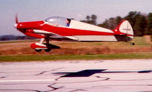

A careful scan of the sky reveals no traffic so I latch and lock the canopy, hang a left and advance the throttle. Stick back as I accelerate. The VW asks me if I really want to do this by dropping 20 rpm or so for a couple of seconds. This used to make my eyeballs bug out and my pulse hit 3000 rpm but now I’m used to it, so I just say “Yes, let’s go!” and hold it steady down the centerline. (This hesitation is due to the carb not having a float bowl, and I think a lot of people have tried to fix it before learning to live with it). Tail up at 40 knots … wake up feet … pull the nose with the toes. Then ease back at 60 knots and leap nimbly into the air.
Sonerai IIL taking off

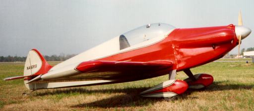

Sonerai-in-progress, in my workshopThe plans for my Sonerai II arrived and my family hid them to present to me as a birthday present. That was March 1979. By July the first boxes of materials and parts came and I set to work building a 2 x 16 foot work bench and cutting tubing.
Some people wonder why it took me over eight years to finish my airplane. I guess it didn’t have to. Others, when they realize the number of parts and the magnitude of the undertaking, marvel that it could be finished at all. I just approached it like a mouse eating an elephant, and kept nibbling away. I guess anybody could build one quicker, but this was a hobby, not an obsession.
