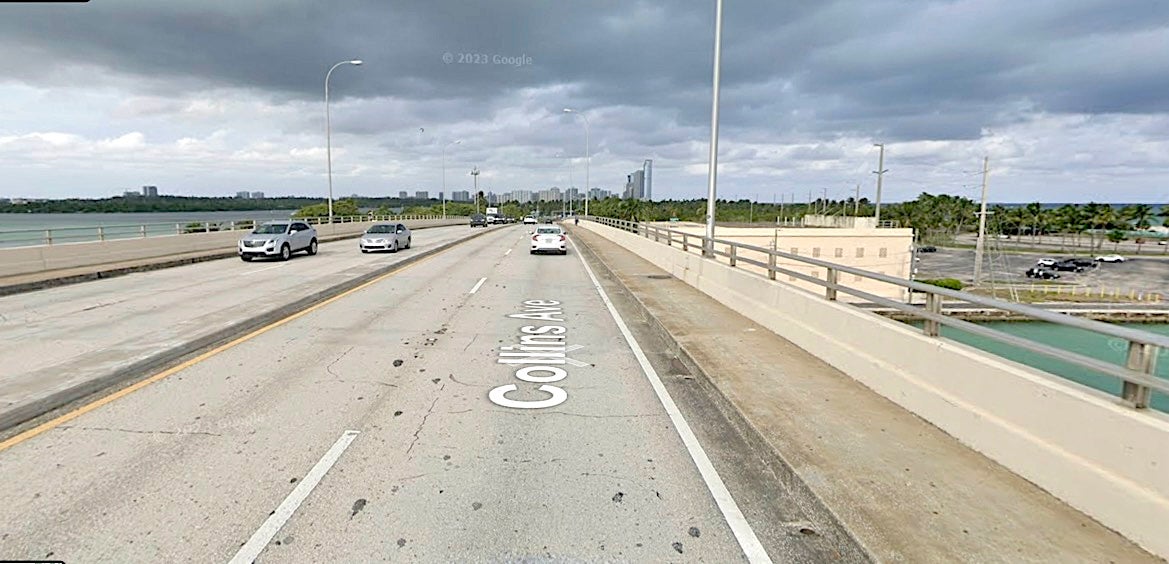

With a passenger who could not swim, the Herman B. Fultz Bridge in Miami appeared to a pilot as his best option after losing engine power. (Image: Google Maps)

The pilot told his passengers he was going to land on the Herman B. Fultz Bridge, which spans the Haulover Inlet. According to the NTSB report, the bridge is about 1,257 feet long and 56 feet wide. “The edges of the deck were equipped with sidewalks, railings, and streetlights,” the report reads. “The bridge was configured with four traffic lanes (two northbound and two southbound) separated by a raised concrete median.”
The NTSB reported that the northbound landing Cessa struck one vehicle from behind and another from the oncoming southbound lane, before coming to rest and bursting into flames.
