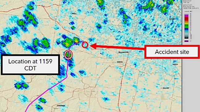

The report newly reveals that about three hours after departing from Louisiana at 8:50 a.m. CDT on May 15, Dr. Doucet was in contact with Memphis Center on a northeasterly heading at 7,000 feet toward his destination of Louisville, Kentucky. He requested a “deviation” and a climb to 9,000 feet as he approached Nashville Approach’s airspace. There were areas of precipitation in the area, though convective activity was characterized as “light.” Memphis Center relayed the request to the Nashville Approach controller, though no reason was given by the pilot for the request. After the switch to Nashville Approach control, the pilot was given a vector of 360 degrees and was advised to expect a turn back on course in about 15 miles.
The vector took him into an area of medium to heavy precipitation. He climbed to close to 10,000 feet and was instructed twice to maintain 9,000, which he acknowledged with “descending to 9,000.” Once cleared to turn back on course, his heading began to fluctuate, and he no longer responded to radio calls. After flying “several miles” toward the assigned VOR, the Bonanza began a tight right turn to 213 degrees and its rate of descent began to increase, ultimately reaching as high as 15,000 feet per minute.
