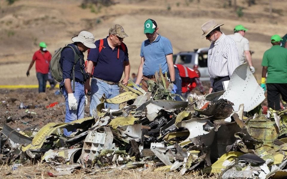

According to a preliminary accident report, the pilots of an Ethiopian Airlines Boeing 737 MAX that crashed on March 10 were unable to manually counter significant nose-down trim before losing control of the airplane in a dive that reached 500 knots. The report, released by the Ethiopian government Thursday, confirms that the MAX 8’s MCAS subsystem, a stall-protection add-on, rolled in nearly maximum nose-down trim in response to a faulty angle-of-attack sensor.
But the report, which draws no final conclusions, is silent on whether the crew simply didn’t know how to use mechanical manual trim or if trim input was inhibited because the airplane was flying at such high speed. The pilots retained takeoff/climb power throughout the accident sequence. Ethiopian Airlines said that following the crash of a Lion Air MAX 8 last October in Indonesia, the crew was briefed on Boeing-provided information on how to disable MCAS. And although some mainstream news organizations have reported that the Ethiopian pilots followed Boeing’s checklist, the report suggests they departed from it in one key detail: After initially disabling electric trim to isolate MCAS, they reengaged it later, allowing the malfunctioning system to trim the airplane nearly full nose-down.

After struggling against the automatic pitch trim and excursions for several seconds, at 5:40:35—about two and half minutes after takeoff—the first officer called “stab trim cutout” twice. The captain concurred and the report indicates the cutouts were used. The 737’s trim system is operated by an electric motor/jackscrew arrangement that trims by moving the entire horizontal stabilizer. In the event of a trim runaway, the cutout switches on the lower pedestal disable the electric motor. But the 737 still has manual mechanical trim wheels on either side of the pedestal that are accessible to both pilots.
Six seconds later, the FDR showed that more automatic nose-down trim was commanded, indicating that MCAS was still sensing high AoA. However, the data showed the stabilizer didn’t respond to this command, confirming that the cutout switches were engaged. MCAS can only move the stabilizer if electric trim is active.
The report indicates that shortly after the cutouts were used, the trim gradually moved nose-down from 2.3 to 2.1 units. It’s unclear why this happened, since electric trim was disabled. At this point, according to the report, both pilots were exerting pitch-up force on the control columns, after the captain asked the FO to assist him.
At 5:41:46—a little over four and a half minutes after takeoff—the captain asks the FO “if the trim is functional.” The FO replied that it wasn’t and asked the captain if he could trim manually. What’s unclear is if the FO meant trim manually with his yoke-mounted electric trim switch or the 737’s mechanical wheel. The training manual for the 737 MAX includes a warning that excessive airloads on the stabilizer could require the effort of both pilots to correct a mistrim condition. “In extreme cases, it may be necessary to aerodynamically relieve airloads to allow manual trimming. Accellerate or decelrate towards the in-trim speed while attempting to trim manually,” the training guidance says.
The data indicates the stabilizer was never moved manually mechanically. However, 32 seconds before the crash, the FDR trace revealed two momentary manual electric trim inputs commanding nose-up from 2.1 to 2.3 units.
This indicates that counter to Boeing’s guidance, the crew reengaged electric trim, allowing MCAS to once again regain control of the stabilizer. In five seconds, it moved the trim nose down from 2.3 to 1.0 unit, a value that’s nearly maximum nose-down in the 737, according to sources AVweb contacted for this story. The aircraft reached 40 degrees pitch down before impacting at 500 knots, according to the FO’s data. According to the report, power was never reduced from the takeoff/climb value.
