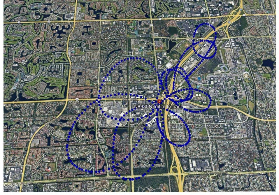

Airport surveillance video showed the aircraft taking off normally before abruptly veering left and entering a continuous left turn. Witness videos and preliminary ADS-B data confirmed that the aircraft completed multiple left 360-degree turns at low altitude. Air traffic control audio captured a pilot reporting an issue with the rudder, stating they were only able to make left turns.
