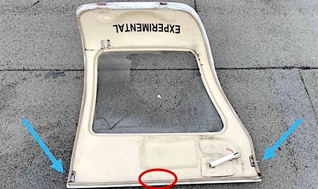

Left cabin door as-found, with the forward and aft door pins marked by the blue arrows. The area that the secondary door latch should have been installed is circled in red. Photo and caption, credit: National Transportation Safety Board.

According to the NTSB report, “The door handle was found just short of the forward closed and locked position, and because it was not fully forward, its locking button had not engaged. The lock pins were found extended about 1/2 inch out of the door ends, and when the door handle was tested by moving it forward, the pins extended a further 7/16 inch and the locking button engaged.”
The builder-owner had also modified the door-unsafe warning system. The NTSB Preliminary Report included: “On the accident airplane, it appeared that only two [of four] reed switches had been installed, with each mounted to the aft pillars of both doors. As such, the modified system would not have warned the pilot if the forward latch pins had failed to fully engage.”
