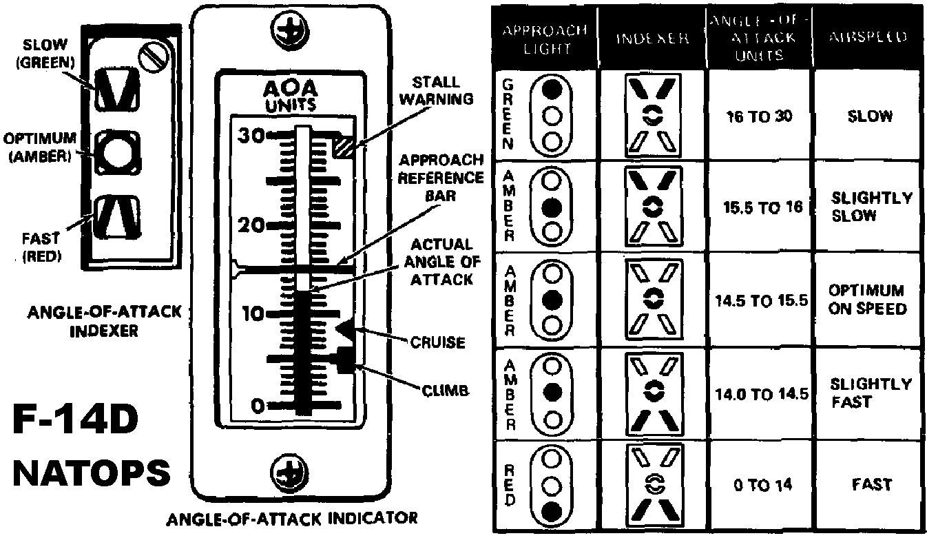

About 15 years ago, the Navy invited me for an overnight tour of the U.S.S. Theodore Roosevelt, which was involved in carrier workups off the Virginia capes. Ahead of that, I spent some time at the LSO school at NAS Oceana flying an F-14 simulator to carrier landings. Like all naval aircraft, the Tomcat was equipped with an AoA indicator and an on-speed indexer that summarizes AoA and, through indicator lights on the nosegear, gives the LSO a continuous and instantaneous readout on the approaching airplane’s energy state. It took my sim instructor about 30 seconds to explain the AoA workings and it took another 30 seconds to integrate its response to my manipulation of pitch in the simulator. Hey, I got this.
As you can see from the graphic I’m including, the indicator has an approach reference bar and a tape showing actual AoA. It uses arbitrary units rather than degrees, but that matters little in interpreting it. The indexer has colored chevrons and a circle to show slow, optimum or fast speed and corresponds to what the LSO sees on the nosegear speed indicator.
I flew four or five approaches using this system. I crashed every one of them. Hit the ramp twice, took out the island and, I think, flew through the hangar deck. But I was on speed for every one of these disasters because once trimmed up, the AoA makes it easy to stay on speed with minimal mental bandwidth. The rest can be devoted to staying on the ball vertically—not that easy—and adjusting lateral lineup; all but impossible for me. I could figure it out eventually, I think, but that isn’t the point. What is the point is that the Navy considers the AoA a critical, everyday tool for pilots that, oh, by the way, has a little crosshatched area indicating that 29 units of AoA will stall the airplane.
