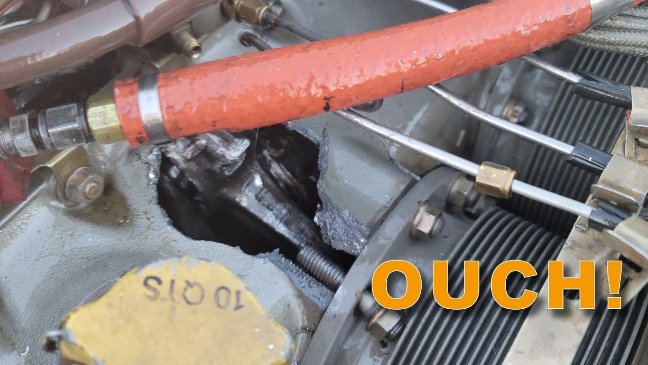

There’s a dense commercial industrial area off the end of 30 and to the west of that, a large open field that might have also been reachable. I wouldn’t second-guess the decision because I wasn’t in the seat and why argue with success? Frye explains the circumstances that led to his predicament. The 210’s engine had just been overhauled but not operated on a test stand. Having read articles about cylinder glazing, Frye found recommendations to run the engine as little as possible before setting full power to seat the piston rings without tanking the cylinder walls. He said it had only been run for a few minutes and he rushed to the runway to get airborne against a setting sun for a few minutes of high-power flight time.
Personally, I’m not a fan of initial break-in by flying an engine. All of the half-dozen overhauls I’ve dealt with have been properly run on a test stand and the resultant data recorded in the engine paperwork. And even at that, on the first flight, I did high-power runups on the ground and returned to the ramp for uncowling and inspection before flight. I did that when we overhauled the Cub engine, which had been run on the stand, albeit a rudimentary one. After an annual, I perform a similar inspection and I conduct at least one high-speed taxi test.
This comes not from personal calamitous experience but from reading scores of accident reports following maintenance and overhauls. Failure of a freshly overhauled engine is not an everyday thing, but it’s not rare, either. The very scenario described in the video happened to a friend of mine, but before takeoff during a high-power runup. I’d rather have it blow up on the test stand or on the ground rather than after takeoff. In Frye’s engine, a rod came unglued and blew a hole in the crankcase, suggesting the undertorquing that is a common failure scenario.
