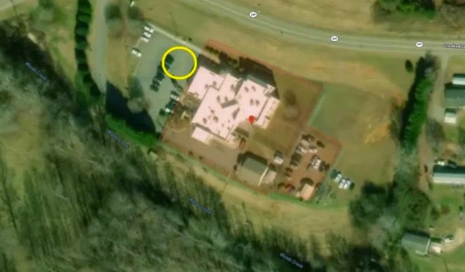

For whatever reason, the pilot chose the parking lot of the Towns County Jail for the flight demonstration. The drone’s geo fencing software marks all jails, prisons and other high-security facilities, like power plants and military installations, as “restricted zones” that the drone will not enter. In the photo above, the prison restricted zone is shaded in red and the yellow circle shows where the injury took place, which is in the parking lot that is adjacent to but not in the restricted zone. The pilot told the NTSB he was unaware of the zone and said he didn’t see the warnings the drone sent as it got near the jail. After his hand was injured, the pilot simply held on to the drone until the batteries were drained. The drone and the remote are being examined by the NTSB.
