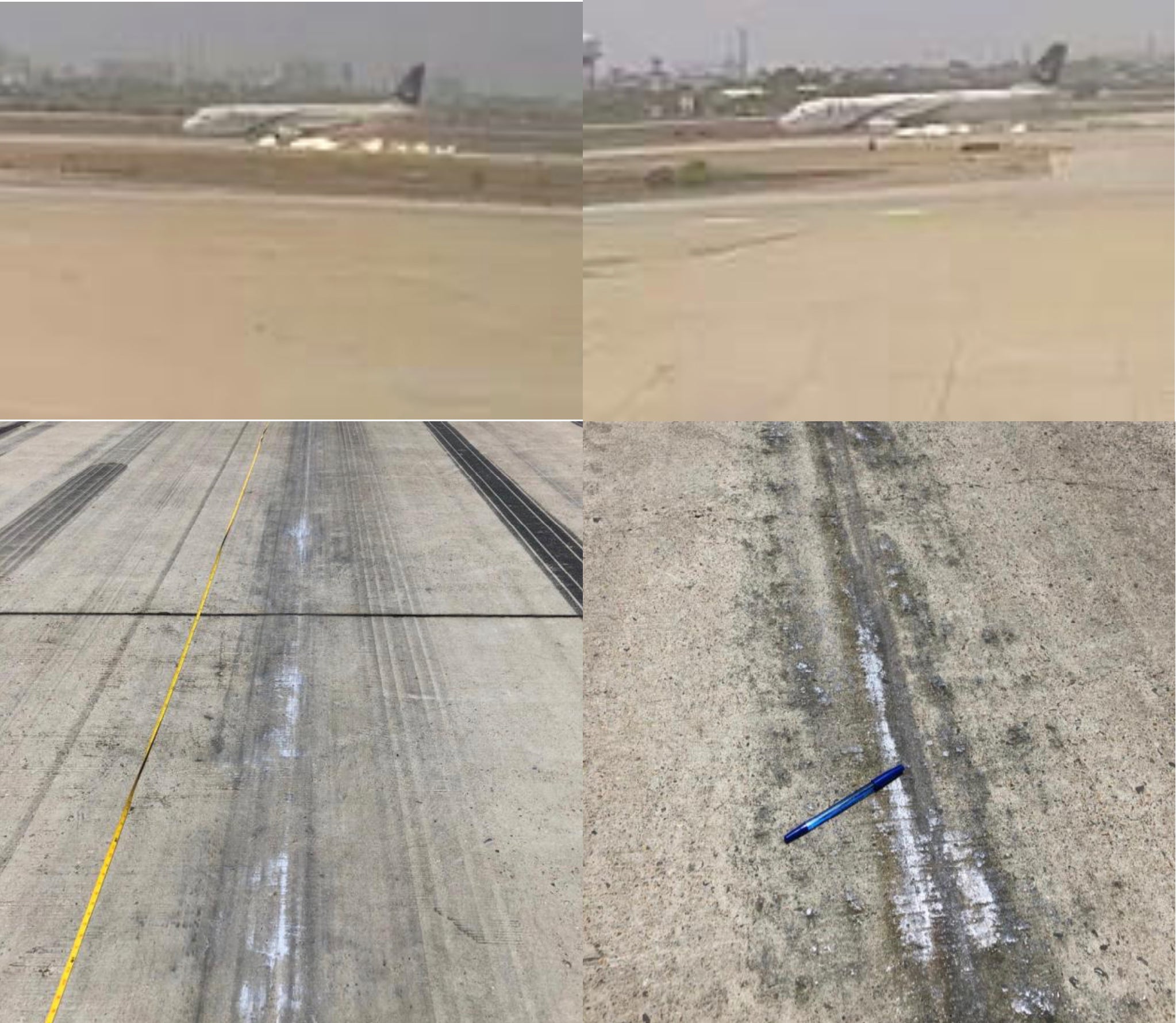

Once reaching glideslope and localizer intercept, the crew raised the gear, retracted the speedbrakes and put out the first increment of flaps, which caused warnings in the cockpit to go off. At 500 feet AGL, the Airbus was traveling at 220 knots indicated airspeed and descending 2,000 feet per minute. The crew continued the approach to landing, eventually touching down on the engine nacelles halfway down the runway. The crew initiated braking and reverse-thrust sequences before initiating a go-around. “Both engines scrubbed the runway at various locations causing damage to both of them,” according to the report. CCTV cameras caught the “aircraft[’s] engines touching the runway and showing sparks due to scrubbing, along with marks on the runway.“
