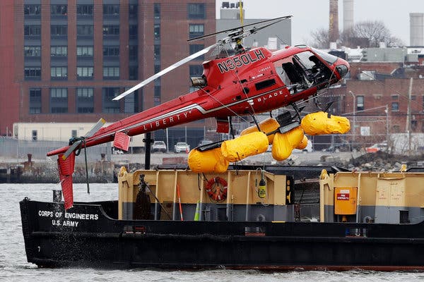

According to the NTSB, “The flight, marketed as FlyNYON, was designed to allow passengers to take photos of the city’s landmarks while extending their legs outside the helicopter. For the flight, Liberty removed the helicopter’s two right doors and front left door and locked the left sliding door in the open position.”
The crash of the Airbus AS350 was traced to the use of a passenger safety harness.  “Investigators determined that during the flight the tail of the front passenger’s tether, which connected his NYONair-provided harness to the helicopter, caught on the helicopter’s fuel shutoff lever, resulting in a loss of engine power at an altitude of 1,900 feet. The pilot then successfully ditched the helicopter into the river,” according to the NTSB report. The board is also recommending modification of the floor-mounted fuel-shutoff valve to prevent inadvertent activation.
During the accident sequence, the pilot deployed the flotation system, but the floats did not inflate properly. After contact with the water, the AS350 rolled over and submerged. The pilot escaped but “the five passengers, each fitted with a NYONair-provided harness/tether system—secured with two locking carabiners—were not able to detach the restraints before or after becoming submerged upside down in the dark, 40-degree water, drowning as a result,” reads the NTSB report.
