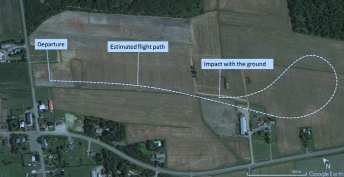

The accident happened in November of 2022 after the pilot pulled the little helicopter out of his garage and launched from an adjacent field so a relative could shoot video. After hovering for the camera, he flew a few hundred yards at low altitude and had turned back toward the videographer when the malfunction occurred. Thanks to the video, investigators were able to watch as the rotor skin came apart at the leading edge, which weakened the structure and allowed torsion in the blade before other parts of the helicopter separated. There have been two similar accidents in the last 30 years, and blade inspections and maintenance are covered in the manuals that came with the helicopter.
