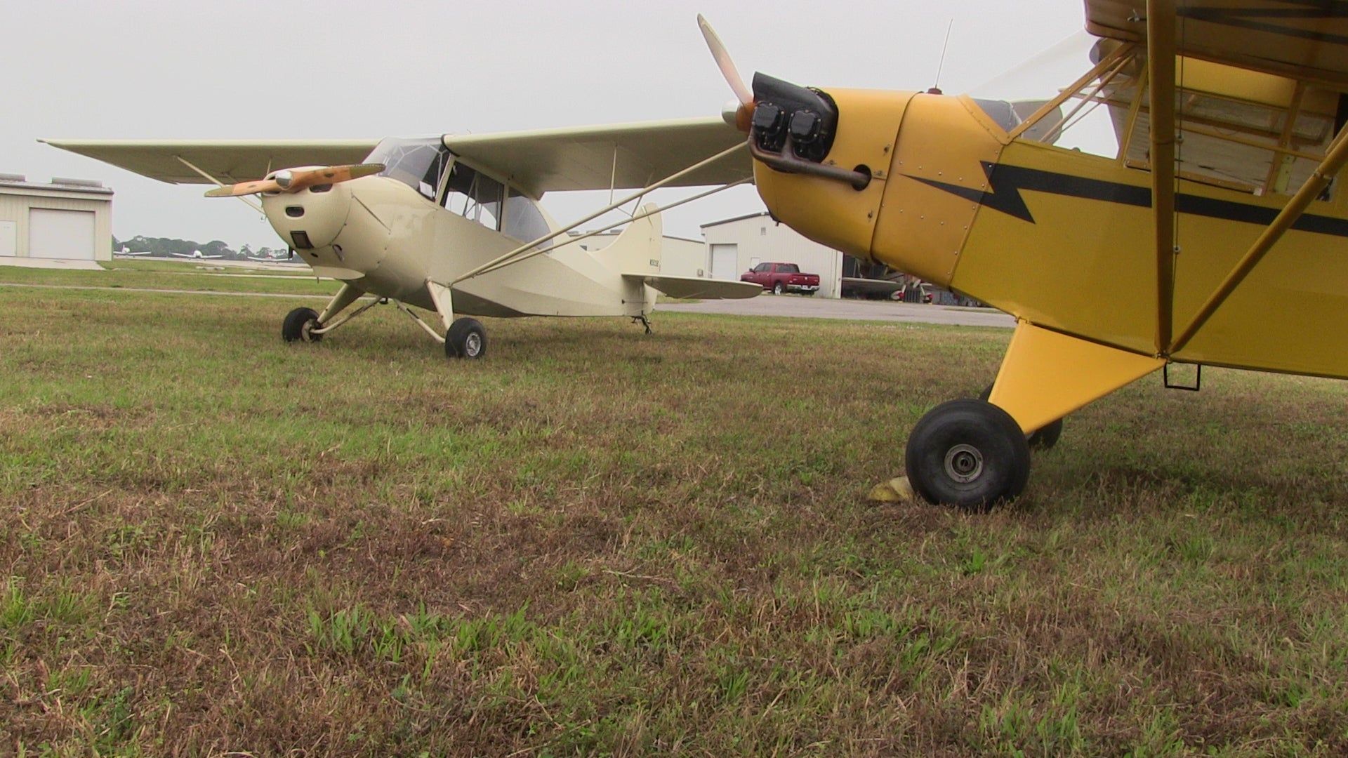

One of those clear winter dawns, and the preheated 65-HP Continental engine popped awake on the first pull of the propeller blade. Standing in the prop blast (I hand-prop from behind) provided time to marvel at how my Aeronca Champ has been so reliable in our 37 years together.
Plus, how increasingly miserable it is to hand-prop airplanes in a Midwest winter. The airplane didn’t care and indicated she needed attention, because flight is, ultimately, all about her. And, yes, she’s a she. Her name, Quinta, is short for Quinta Essentia, the Fifth Element, a name she revealed to me shortly after she found me eying her from across the ramp at a now defunct little airport in the Santa Cruz Mountains of northern California. I tried to pretend I was chatting up a nearby Cub, but she knew and after our second flight together revealed the source of her name.
Long before Maurice White discovered the periodic table, philosophers believed that five elements constituted existence: Earth, wind and fire …. No. Make that: Air, earth, water and fire with a fifth element, more mercurial than the others, promising flight. Or that’s how Quinta explained it after she took me in.  Anyone who thinks we humans buy and own airplanes is, frankly, delusional. Like cats, they select us, while we merely provide for their every whim, and some are maddeningly more whimsical than others.
Back to the morning start. Oil pressure rose within seconds, and I knew oil temp would barely nudge off the peg by takeoff. She’s cold-blooded but loyal, or, “Yar,” as Kathrine Hepburn described a sailing yacht in the movie Philadelphia Story (1940).  After thousands of intimate hours together—with Quinta, not Kate—I know how she flies, but more importantly, I anticipate her expectations.
Meet them, and the sky’s no limit. Fail, and she’ll humiliate you with a bounced landing only YouTube could love. So, when the right mag sent a butt-jiggling shudder through the airframe, I knew she was demanding that I make good on promises to address maintenance squawks deferred since spring … of 2014.

After Quinta’s morning snit, I called the mechanic who quickly came to my rescue—a good deed that would not go unpunished. To make room in his shop, we rolled his Cessna 172 into my hangar and my Champ into his, where he quickly diagnosed a fouled plug, which was easily fixed. Unfortunately, I had to open my big mouth and say, “While we’re here …” and shared Quinta’s squawk list.
Hours later, the prop was removed for painting, likewise the spinner. The nose bowl had a minor crack in the paint but it had penetrated the fiberglass, so it’s now on the bench awaiting patches. And while we’re there, several Dzus fasteners were sloppy, so let’s replace those. Moving aft and lower, I mentioned that the left brake sticks (mechanical drum and cables, not hydraulic), as does the throttle cable, so we opened the boot cowl, removed cabin side panels and replaced suspicious cables, because a good mechanic—the kind who simultaneously vexes and protects lackadaisical owners from ourselves—looks for what looms ugly over the horizon.
After drawing blood while running his hands along the rudder cables, he ordered—not requested—me to remove the floorboards and, “While you’re there, clean out all that grass and mud dauber grit that’s accumulated in the belly since the annual.” Found the pen I’d dropped last summer, too.
