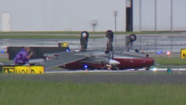

  • A Diamond DA42 at Orlando Executive Airport was unexpectedly overturned by a 54-knot microburst while taxiing, resulting in one fatality and one serious injury.

Before I get to that, here’s the preliminary report on the accident. A student and instructor were taxiing out for departure at Orlando Executive with a thunderstorm building to the north and east. During the taxi, the wind was 150 at 11 knots, gusting to 16 knots. That’s hardly a no-go. Sixteen minutes later, while they were in the runup area, what appears to be a microburst drove the wind to 54 knots and flipped the aircraft over in place. The student—an experienced pilot from Nigeria—was killed, the instructor with him seriously injured.

Did the two pilots of the DA42 at Orlando think that? Or did they even consider it at all? Would you? And here a word about Diamond’s crashworthiness. In 2011, I undertook an exhaustive safety comparison of popular GA aircraft crash fatality rates. Diamond swept this field with a 0.35 rate for the DA40 and 0.54 for the DA42. That compares to 1.2 (then) for GA as a whole and 3.25 for the Cirrus line. Since 2011, however, thanks to improved training, the Cirrus rate is much lower. I have no reason to believe the Diamond rate is any different now, but I’ll make that conditional upon reviewing the intervening 10 years of accident data.
A poster in my Facebook feed said there is good evidence that Diamond aircraft aren’t as crashworthy as other models. I would contest this, given the company’s overall excellent safety record, low number of crashes and virtual absence of post-crash fire. Still, in the Orlando crash, someone died who shouldn’t have expected to in a stationary rollover. What happened here?
The DA40 and DA42 have, in effect, a roll bar consisting of a robust composite hoop that runs from the sides of the fuselage slightly aft of directly over the pilots’ heads and serves to anchor the forward-tilting canopy. Did this somehow fail? Was it not adequate for the loads encountered? The answers await further investigation by the NTSB.
When the Diamond aircraft first appeared, every review we did raised complaints about the egress limitations of canopies and upward opening doors. This is true of the Socata line and, to a degree, the Columbia and Cirrus aircraft. We sometimes worried that these would trap people who might have otherwise escaped and survived. There is no persistent pattern of this happening. Yes, the Diamond airplanes have upended—although it’s not common—but this accident may be the first fatality related to lack of overhead protection.
If that’s so, Diamond may want to look at this design and see how it might be improved. It seems to me that it would take an enormous impact load to fail that overhead bar. Meanwhile, this is a point of departure for the rest of us to consider the state of restraints in our aircraft. One of the Diamond accidents involved the failure of a seatbelt fitting. There’s no reason that should ever happen in a properly maintained airplane.
