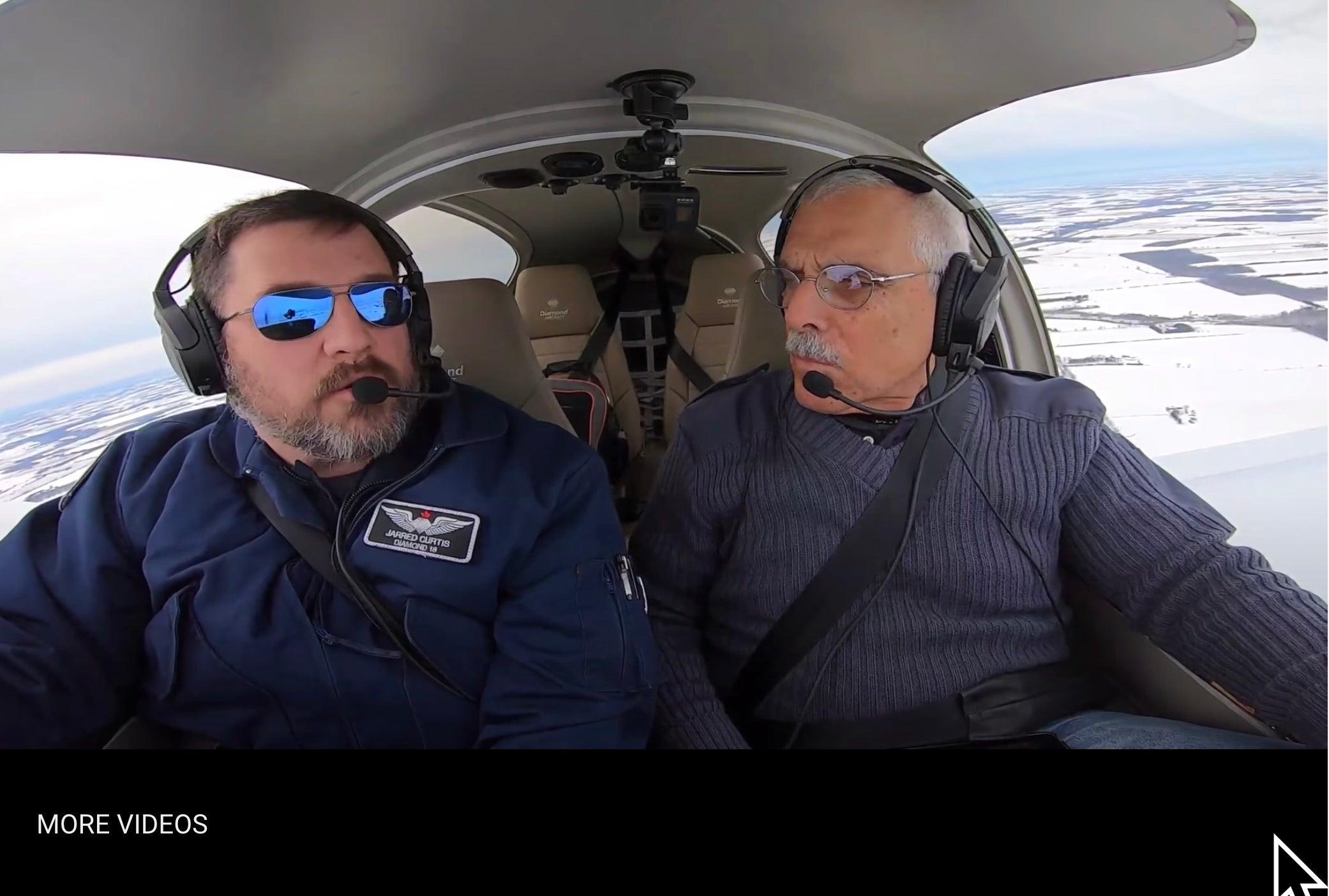

A month ago, I actually killed a video for this very reason. But I’m resurrecting a frame to show you why. It was in a video on the Velocity experimental aircraft. The belt design is not too bad as these things go; the shoulder component is reasonably positioned. But like so many belts of this design, it takes effort to get the lap portion down low on the hips, where it’s supposed to be. In addition to having the shoulder strap twisted, the lap and buckle are too high, hitting me just below mid-chest. Mea culpa. This is operator error that I should have caught. I hated it enough to bury the video forever. And for the record, I would install four-point belts in anything I built or own.

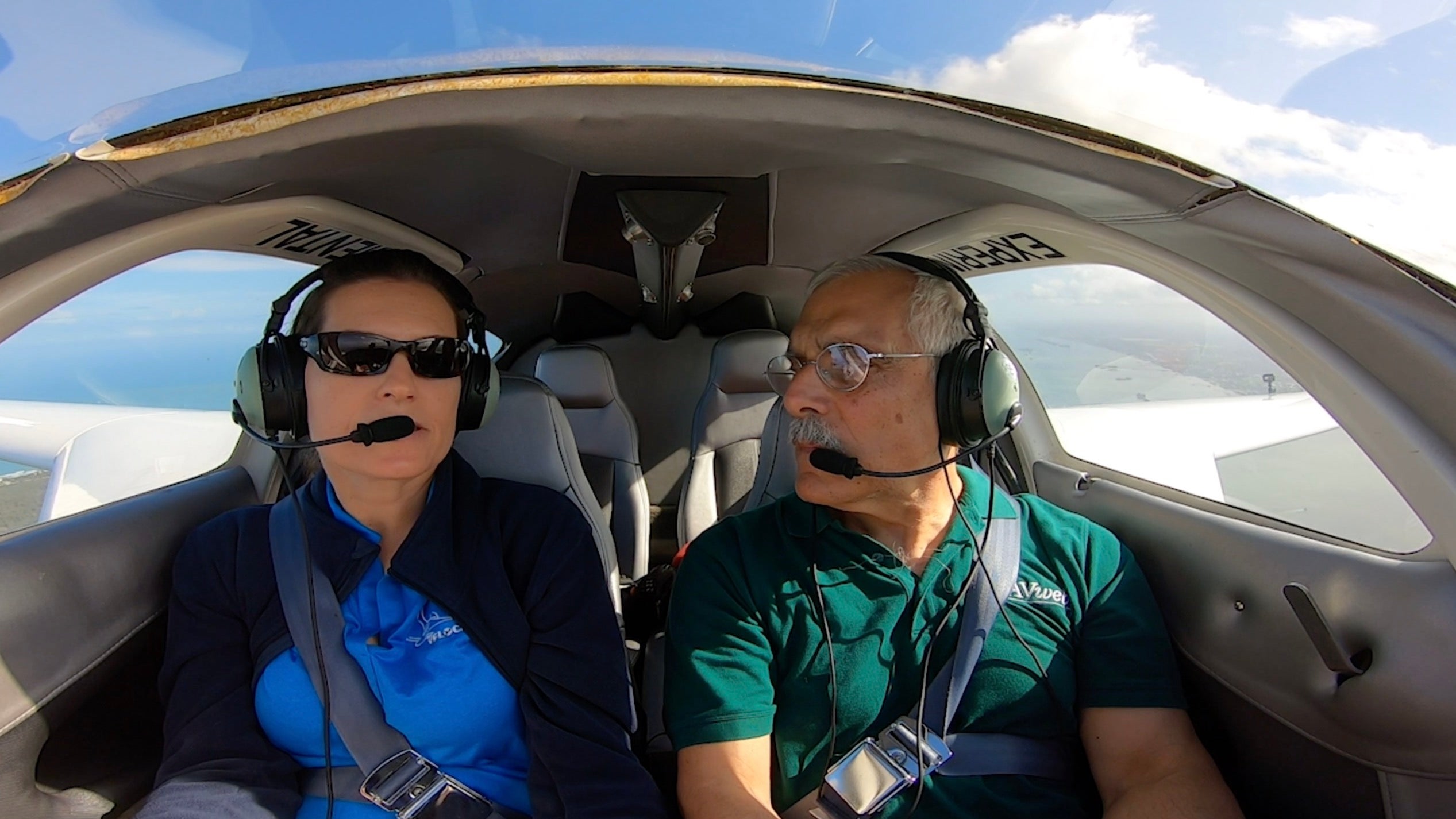

I was all prepared to ding Cirrus on their substandard seatbelt but then, as Warner Wolf used to say, I went to the videotape. Faulty memory. The Cirrus belts are excellent four-pointers that have just the right angle to stay off your neck and remain comfortable without being too difficult to adjust. I must have been thinking of another new airplane.
