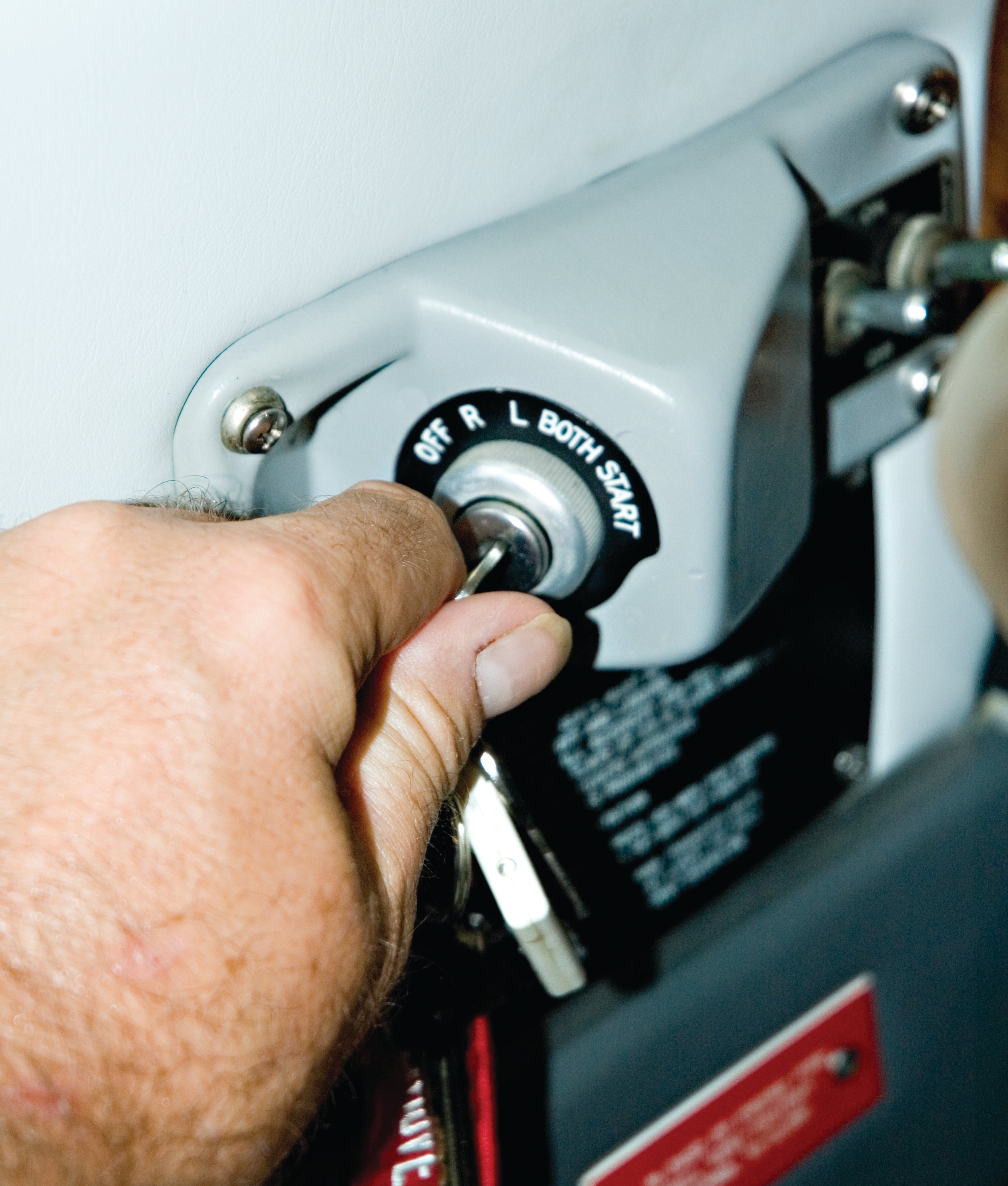

I’ve been starting my 75-year-old airplane by hand for 39 years and still have all 10 fingers. Adding those figures together nets 124, which is the number of possible ways to mangle a forearm or, worse, flood the engine if I don’t employ the exact starting ritual, perfected through trial and frustration. Beyond the “three shots and four blades” for warm weather starts, I set the mag switch to LEFT, because the left magneto alone has the impulse coupler, which retards the spark for easier starting. Easier being a relative 1940s term. Magneto being an 1890s term.
With the left magneto set to fire, the throttle is “cracked,” a calibration defined at the Council of Trent in 1545. Cracking in my airplane is 5/16 of an inch (7.95 mm). Once all steps have been met, the person dragooned to spin the propeller does so with precise downward pressure and snap to rotate the crankshaft to trigger the mag spark that ignites the compressed fuel/air mixture, while not lingering in the propeller’s arc during that millisecond, perhaps longer, as the power-stroked cylinder inspires the others to explode in sequence. For my engine that order is 1,3,2,4, repeat. It’s a chemical/mechanical marvel. The marvel being it works at all, which occasionally it doesn’t. Usually when already apprehensive passengers await.
