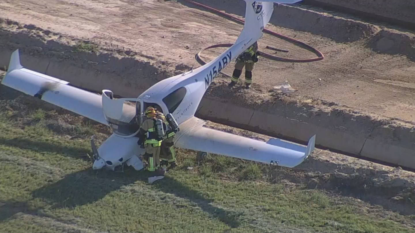

And just as soon as I think I’ve seen the most bizarre thing imaginable, I find another one that plummets below even that standard. Like this accident (PDF). I’m working on a follow-up report on the engine failure video we published last week. I unearthed this accident because I wondered if there had been any failures of the Austro AE-300, which I consider to be the most refined piston engine in general aviation today.
The almost comically sad summary is that this crash happened to a 14-hour student pilot on his first solo. The engine rolled back to one-third power because the shop replaced two induction hoses with the wrong type, one that had an inner lining that wasn’t stitched. This caused the hose liner to collapse and starve the engine of air. The airplane did not come from the factory with that hose. The long and the short of it is we handed a well-engineered, modern airplane with a superb safety record and an engine to match to a 25-year-old student pilot who got an e-ticket ride through power lines and drainage ditches because mechanics installed the wrong hose. On the upside, it looks like the student was well trained and performed admirably.
And let me interrupt the flow of this commentary for a brief rant. This accident still doesn’t have a final probable cause from the NTSB. It occurred exactly four years ago almost to the day and is still in progress. Frankly, this is pathetic. The NTSB should be doing better than this. A lot better. When you read it, you’ll realize that the G1000 in the airplane provided excellent technical data and an engine inspection filled in the rest. Now, back to your previously scheduled blog.
