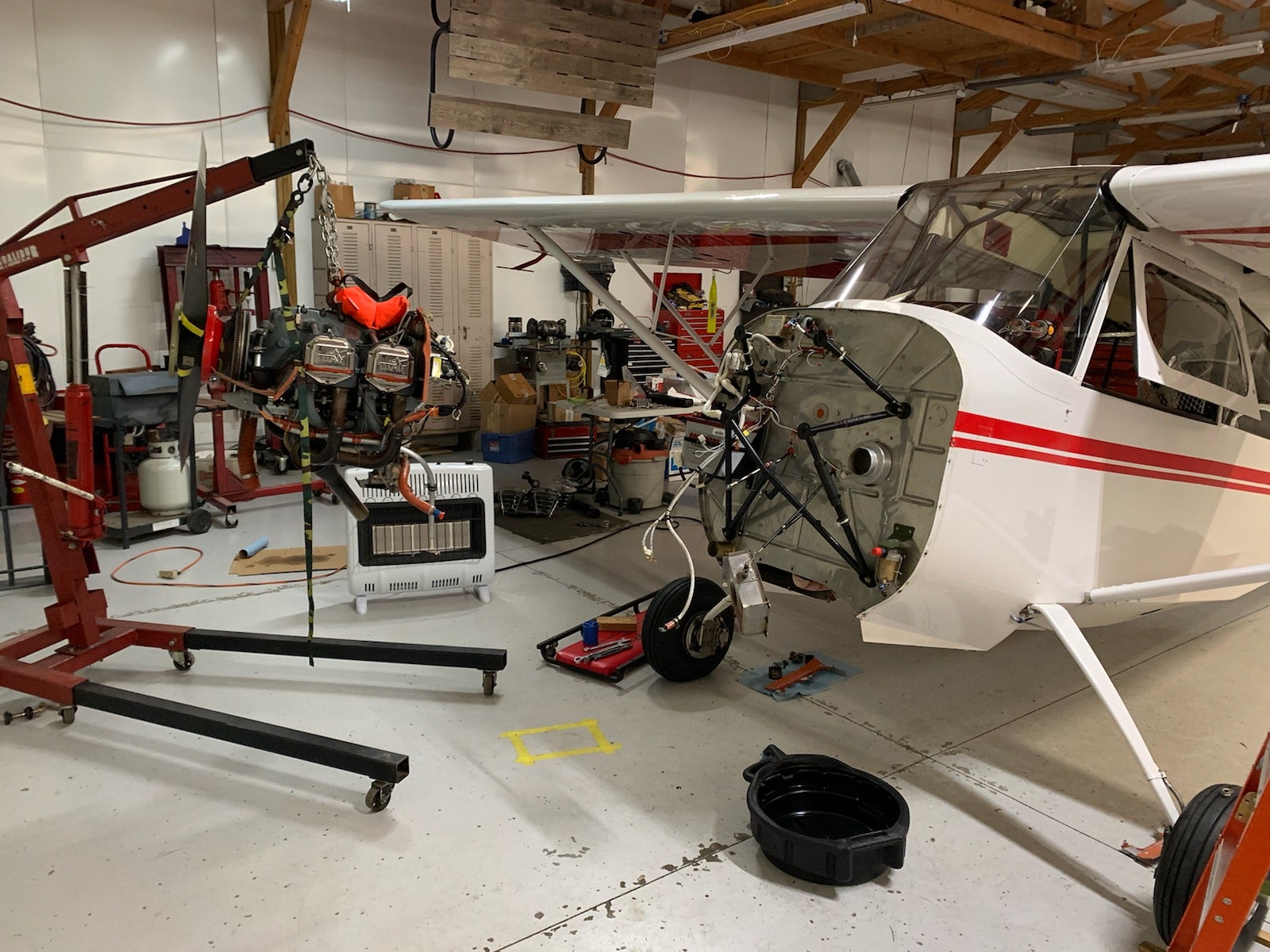

Meanwhile, the parallel universe Citabria maintenance got a little out of hand. At the completion of previous budget-defying annuals I’ve muttered to amused mechanics, “At least next year it won’t be this extensive or expensive.” That’s rarely the case. The 7ECA Citabria has been eating up rubber engine mount bushings since I bought it five years ago. American Champion Aircraft (ACA) provides good tech support and suggested I buy a new, beefier conical engine mount. Not too expensive but, unfortunately, not in stock so “give us four weeks to fabricate one in any color so long as its black.”  Into the third week of waiting, but hope and rationalization spring eternal, and with luck I’ll fly before spring 2023.
After placing the order, I felt giddy with fantasies of flight behind an engine that wouldn’t lose its grip, when the law of unintended consequences poked its beak into my euphoric bubble. Every action in aircraft ownership causes an equal and unforeseen reaction. After ordering the new hardware, we realized that the additional curved tubing that gives the mount its beef also blocks engine baffling vent tubes, there to cool the magnetos. ACA tech support anticipated my follow-up call and added appropriately modified baffling to the order.
