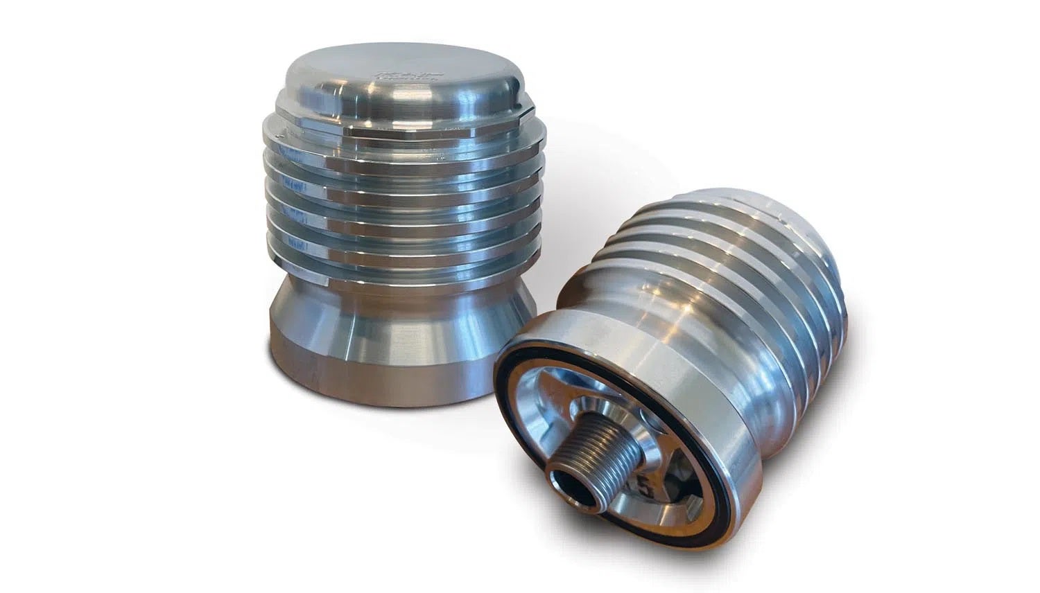

Among the many effects of the supply chain problems in the summer of 2022, aviation discovered that it was having a difficult time functioning without a simple commodity—the oil filter. Lycoming and Continental engines everywhere needed spin-on, disposable oil filters to keep flying, and the supply was extremely limited. KITPLANES research found that Champion had effectively stopped production—though it is now ramping back up—while Tempest was going at their normal production rate and trying mightily to increase it to meet demand. But Tempest simply couldn’t double its production overnight, so suppliers’ shelves emptied as aircraft owners quickly bought up every filter they could find. Remember the toilet paper shortages in the early days of COVID? Yeah, it was sort of like that.
The permanent filter is smaller in diameter, shorter, and ribbed (for cooling) compared to the standard disposable filter.
Homebuilders searched their favorite forums to see if anyone had an extra filter on the shelf when it came time for an oil change, and as a hopeful sign of civility, many filters changed hands so that pilots could continue to fly. Some oil-change intervals might have been fudged—but for personal Part 91 operations, nothing says that you can’t go an extra 10 hours if you choose to do so. Not so lucky were flight school and rental-fleet operators, many of whom discovered that they had to find filters—at any cost—or stop operating some (or all) of their aircraft when inspections and oil changes came due. Lack of a $40 oil filter turned into much lost revenue.
Fortunately, there is—and has been for many years—an option to spin-on disposable filters. And no, I am not talking about going back to the simple oil screens that engine manufacturers used for over half a century before disposables came along. The original screens (I had a couple on my early airplanes) were comparatively very coarse, which meant they needed to be cleaned and the oil changed every 25 hours, according to Lycoming. Spin-on filters allowed intervals to be stretched to 50 hours—a welcome cost savings for aircraft owners, both certified and Experimental. Spin-on filters had, of course, been used in automobiles for a century—but took a little longer to make their way into aviation. Now, of course, they are pretty much the de facto standard. But an alternative is the permanent, cleanable filter that attaches to the same adapter as a disposable, spin-on filter.
Pioneered in general aviation by Challenger Aviation, the permanent filter has economic advantages in the long run (it will pay for itself after a certain number of oil changes) and reduces waste. And based on testing performed by K&P, which manufactures the filters for Challenger, it appears to provide better filtration and higher oil flow rates—both of which should be better for your engine.
The interface end of the filters shows that the seal on the permanent filter is smaller—but it is an X-shaped O-ring, providing two sealing surfaces (left). Oil flows into the filter around the edges and out through the center. The 8110-2 filter style has a nipple installed in the filter (right). You need to purchase these separately for the S-15 filter, and install it with some red Loctite to adapt to your engine.
