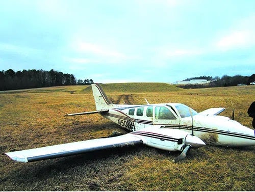

Settle back into your armchair now. We decided to abort the landing, but that was after some surprises popped up late in the game, making the go-around much more critical. Here’s an actual example of what happened at Monroe when the pilot continued the approach. In 2015, a Beech Baron landed long on Runway 5 during the ILS approach. The pilot was unable to stop before the twin went off the departure end. There were no injuries to the pilot or three passengers, but the aircraft was substantially damaged. According to the NTSB records, the pilot reported planning the RNAV 23 at KEQY, with 939-⅞ for the LPV. But with weather below that, he changed to the ILS 5 to get the DA of 883 feet with ½ mile visibility. Reported weather at the time was ¼ mile visibility, indefinite ceiling with vertical visibility of 200 feet, wind 230 degrees at 11 knots, according to the NSTB summary.
Moreover, a NOTAM for Monroe was in effect, raising the ILS ceiling minimum higher than that published for the RNAV 23: ILS OR LOC/ NDB RWY 5, AMDT 1A… S-ILS DA 975/HAT 297, VIS 7/8 ALL CATS …  GLIDESLOPE UNUSABLE BELOW 97. (There’s no mention of the RNAV 5 in the accident report.) The TDZE there is 683 feet and Runway 5 (only) has an approach light system.
The pilot reported he had flown the ILS 5 to “about 100 feet above decision height” but “did not have the runway environment in sight” and made moves to go around, but did not go so far as to increase power. He then saw the runway centerline and continued for landing with full flaps. He reported flying normal speeds of 105 knots on approach and 85 at touchdown. He estimated landing about 6000 feet down the 7001-foot runway, applied braking on the wet asphalt with flaps still down, and was unable to stop.
It’s not clear if “about 100 feet above decision height” means the NOTAMed DA or the published DA. Either way, though, it appeared he stayed there for a bit as he prepared for the missed but didn’t add power. Assuming he saw the lead-in lights and red terminating bars, with sufficient visibility the pilot was legal to land under §91.175. He was also legal to land upon seeing the runway centerline markings, but his hesitation took him too far down the runway to safely land. Using discernible brake marks on the pavement and the tracks on the grass, the NTSB estimated it took 1600 feet from touchdown to stopping. The board’s probable cause: “The pilot’s failure to maintain a proper glidepath and failure to perform a go-around once a safe landing could not accomplished, which resulted in a landing area overshoot and runway excursion.”
