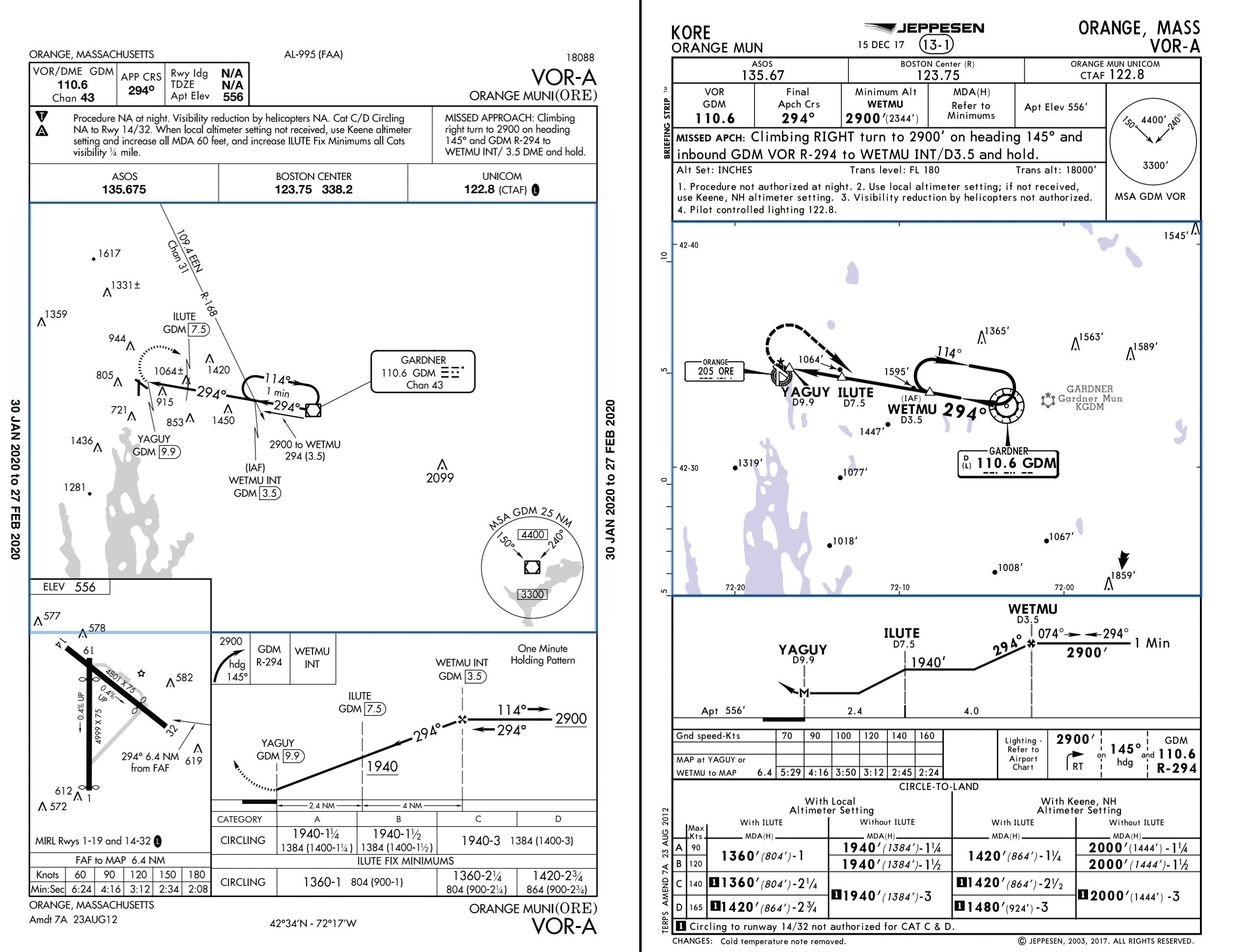

Different Strokes
This article was originally published in April 2020. Information used in this example is not current.
In the plan views for the VOR-A approach into Orange, Massachusetts (KORE), shown below, the FAA/Aeronav version (left) depicts a feeder route from the Gardner VOR/DME to the procedure’s initial approach fix, WETMU, plus a crossing radial from nearby VORTAC EEN (Keene, N.H.) as another way to identify the fix. The Jeppesen version of the same procedure (right) lacks the feeder route and the cross radial from EEN. The profile view for both versions of the plate (not shown) correctly depicts that WETMU is also identified as the 3.5 DME fix on GDM’s 294 radial.
Per a forum discussion on the BeechTalk.com website, the Jeppesen plan view omits the feeder route from GDM to WETMU and reportedly will be corrected, along with adding the cross radial from EEN, with the next chart revision cycle.
The main point here isn’t that someone made a mistake, but that the two major sources for this aeronautical information presented the same underlying data differently. Another point is that, as this article neared its final deadline 10 or so days after the difference was identified, there was no official notification for users. That’s how a lot of charting details seem to resolve when identified, so don’t be surprised by changes..
Special thanks to the knowledgeable and experienced commenters at BeechTalk.com who pointed out these differences and their solution.
