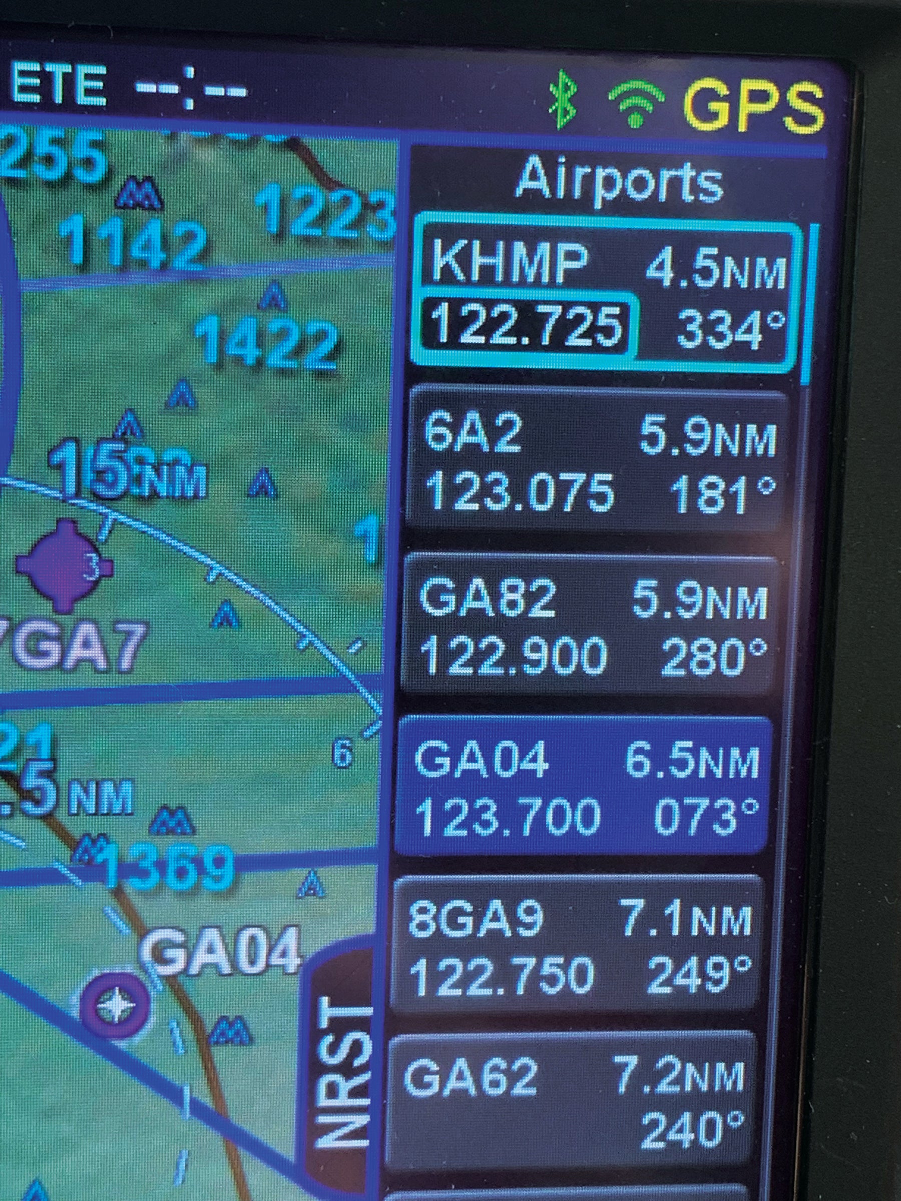

Checkpoints: The 2-Mile Decision
As seen on the GPS “Nearest” function (recreated post flight), KHMP turned out to be the closest—and best—decision.

Air, fuel, spark, right? Aviate first! Having just set a course to Alexander Memorial, I knew exactly where I was, and I wasn’t real excited about it. I was pretty much equidistant from three airports, one 90 degrees off the left, one 90 degrees off the right, and home base right behind me. Griffin (6A2), off to the left, was heavily populated with shopping areas, a heavily traveled highway, and not many open fields between me and it. Henry County (KHMP), off to the right, had some open fields, including one grass runway that had been plowed under. All of my tools were, of course, at home base, and it was a very strong urge to turn back to there. However, there were stores and electrical wires very close to the final approach, making a short landing very dicey, so I stopped the right turn with Henry County on the nose and never wavered from that decision. The VSI was showing 400 fpm down, and I figured I could make it.
