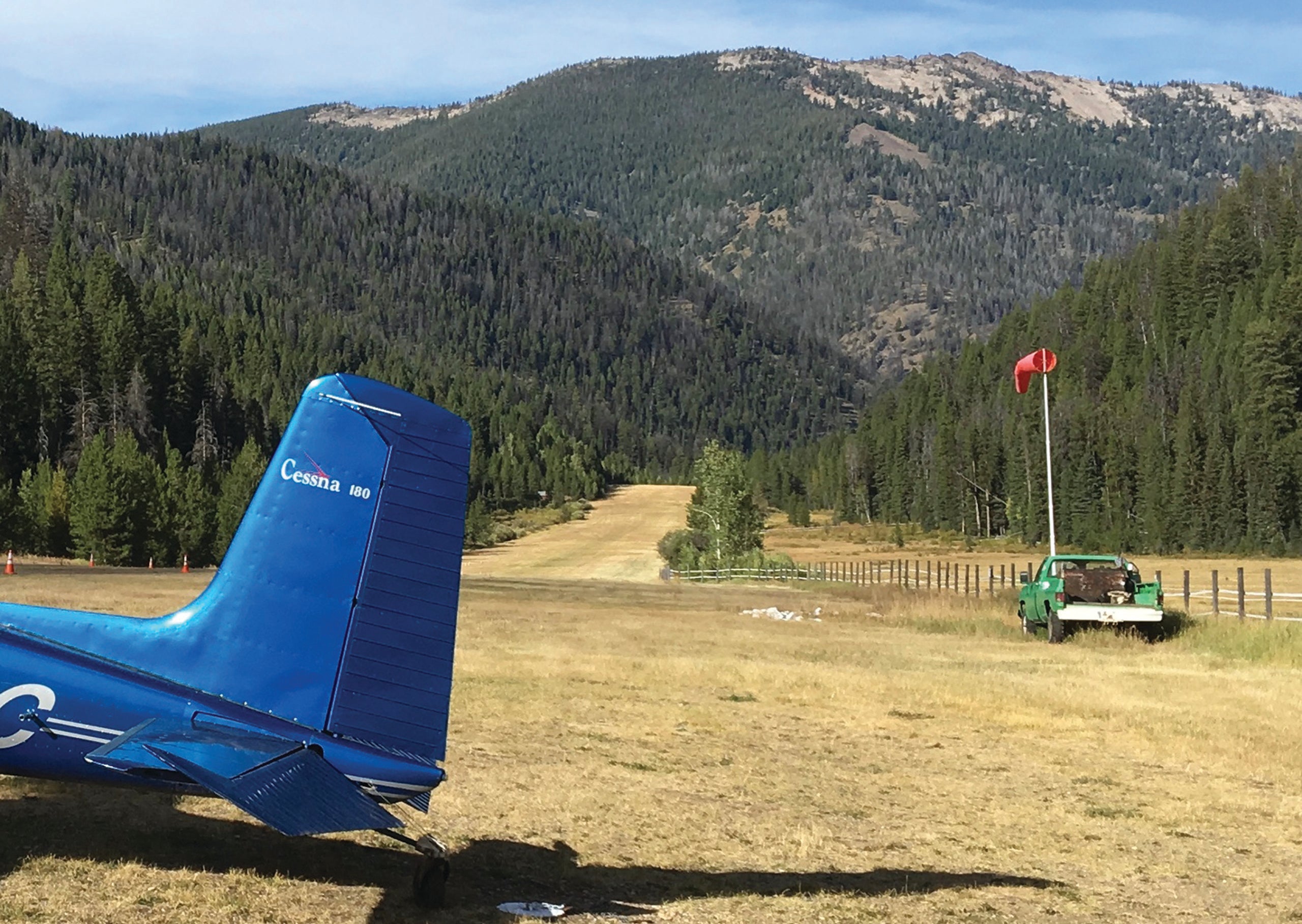

The runway elevation profile at the Big Creek airstrip in Idaho, U60, shows a 0.97 percent grade oriented north and south, with a 35-foot difference between ends. This is the strip pictured at the top.
