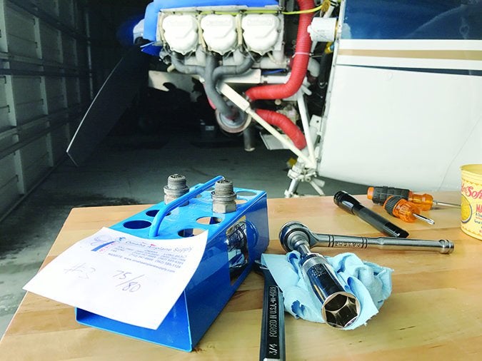

Led Fouled Spark Plug
Metallic lead, which looks like small glass beads, can be found in the combustion chamber and the exhaust port, but spark plugs are a notorious place for lead to deposit when the cylinders are relatively cool. Lead deposits are electrically conductive, which can cause the spark plug to short out. They are also corrosive and can help erode nice round electrodes into a misshapen oval that tells you it is time for new plugs. The spark plug shown is a typical massive electrode version—fine-wire plugs are more resistant to lead fouling.
Rotate low spark plugs to top position, and remove, inspect and clean spark plugs that might be suspect. Lower plugs in an engine run dirtier than the top plugs. If the engine is running massive-electrode spark plugs like the one pictured above, changing to (admittedly more-expensive) fine-wire plugs may help cure lead-fouling problems.
