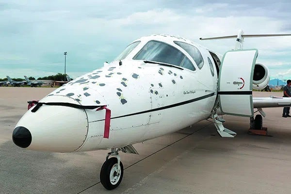

That's a T-1A Jayhawk blemished by a hailstorm that swept through the Laughlin Air Force Base in Texas in 2017. The damage is severe enough to require skin replacement. Photo: U.S. Air Force/Teresa Pittman.
