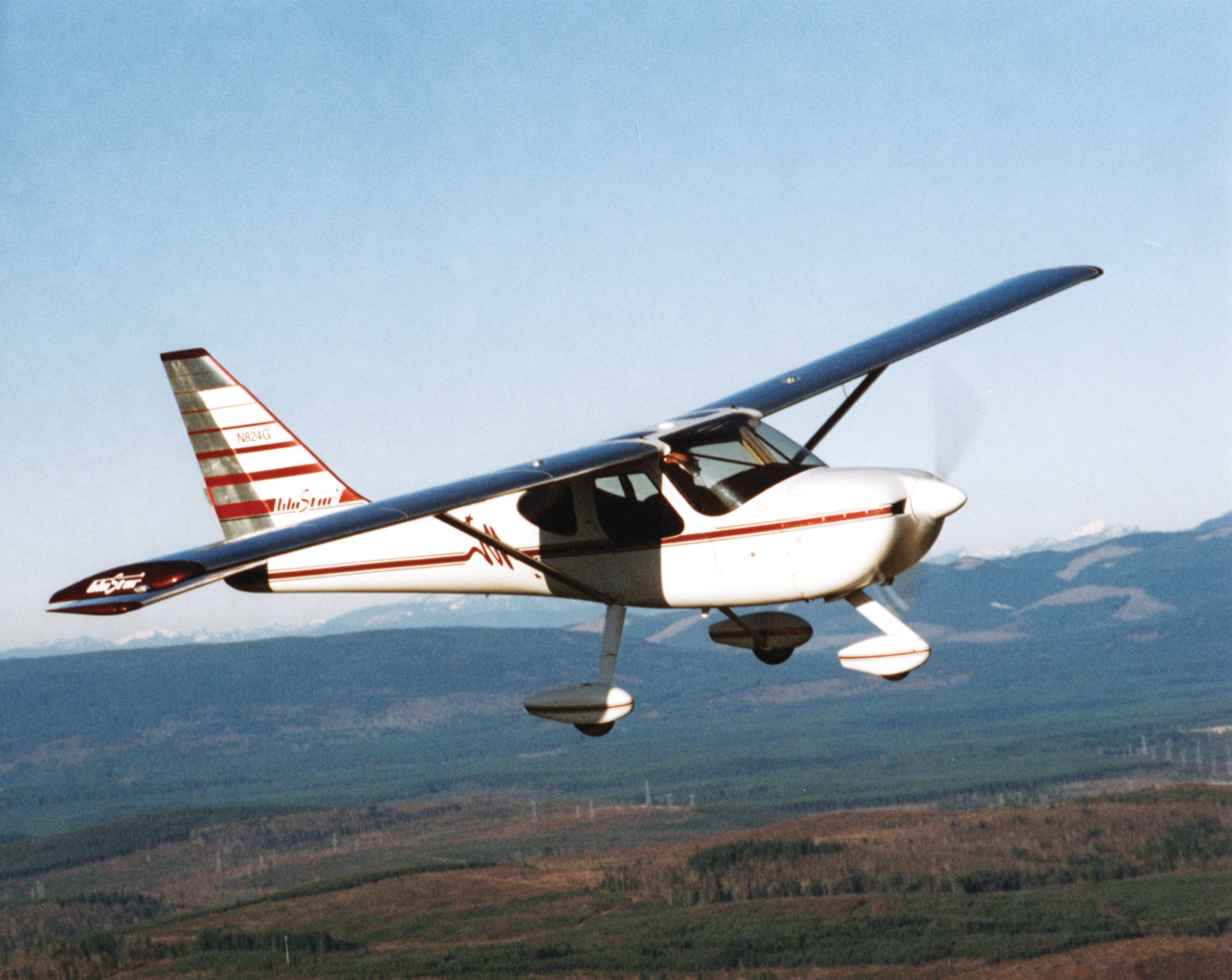

The GlaStar Sportsman line saw about 60 accidents from 1998 through 2017, of which only seven were fatal.
