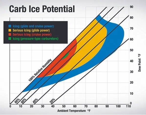

Chilly Carburetors
An instrument-rated Commercial pilot operating VFR experienced a sudden power interruption in his Cessna 150, followed by a surge and another interruption. He pumped the throttle to get intermittent power and enriched the mixture but did not apply carburetor heat. Gliding toward a diversionary airport, he activated the carb heat, but the engine was probably too cool by then for there to be enough heat left.
A full-power ground run and fuel check confirmed the problem was carburetor icing. Icing, we are taught, is gradual, and the pilot had experienced that. But a sudden, severe power loss felt more like fuel contamination or a sticking valve, so he troubleshot that instead. He later realized he had violated his own rule to apply carb heat first at the initial sign of an engine problem. He also moved the emergency checklist from the glove box to the glareshield—a smart move.
A pilot was en route IFR in a Mooney M20 in VMC when the engine began running rough during descent. To maximize his options, he immediately advised ATC. The pilot ran the emergency checklist, including “carb heat on.” Oddly, the list said if engine roughness did not improve, turn it off after one minute. The engine improved momentarily, then began losing power again. He kept trying carb heat, but the engine continued to run at 40 to 80 percent power.
After landing at a diversionary airport, the engine ran smoothly, confirmed by a normal engine runup on the ramp. Inspection revealed the butterfly valve did not move when carburetor heat was applied. It should shut completely when carburetor heat is on. Moving the control back and forth freed the butterfly valve, after which carburetor heat worked properly. Additional runups produced a larger carb heat RPM drop than earlier in the day. The pilot noted the position of the control lever with the heat fully on. The airplane flew home normally.
The pilot thought staying calm, working the checklist, and ATC’s help managing the diversion helped him focus on the problem rather than worry or succumb to fear. He recalled the runup at the beginning of the day when he noticed an RPM drop using carburetor heat but less than usual. He learned to be more alert for carburetor ice symptoms and subtle mechanical issues that might not be immediately obvious.
If something seems off, it probably is. Should something go awry, repress your emotions. Instead, focus on resolving the problem.

Apply pitot heat before entering IMC. Use carburetor heat according to the chart or at the first sign of engine roughness. Turn it on full and keep it on until the engine runs smoothly. Carb ice is possible between -7 and +38 degrees C.
