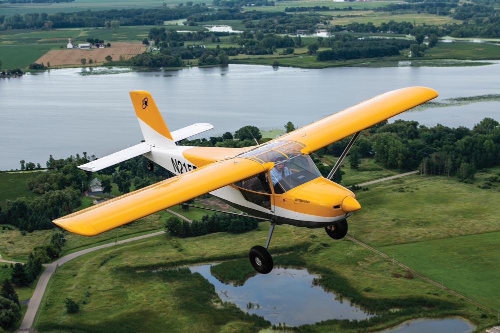

Randy Schlitter, owner of RANS Designs, Inc., has been working on an all-metal utility airplane kit for going on three years now. Subscribers to his newsletters have tracked the progress of this plane since August 2016, and orders have been pouring in for several months now. It seems that people just can’t wait to get their hands on the new RANS S-21 Outbound. And why not? The S-21 promises to surpass the performance of the popular S-20 and take way less time to build. After taking a good look at and flight testing the RANS S-21 Outbound with the 180-hp Titan (Continental) engine, I can say that RANS has fulfilled both promises. The RANS S-21 comes in two versions: trike and taildragger. It is not difficult to switch between gear configurations, but the main gear legs are different, with the trike legs being shorter. Over 90% of current S-21 orders are for the taildragger version.
I was taken aback recently when a group of RV owners began saying this is what the RV-15 should look like. Not that Dick VanGrunsven has even hinted at such a development, but they all seem to want a high-wing utility plane they can use to knock around the backcountry. It’s nice to be able to get from here to there at 180 knots, but if there ends up being a 1200-foot dirt strip, an RV-8 doesn’t look like the best choice for the trip. The point is that the utility plane is the hot ticket right now, and RANS seems to have come up with just the right plane at just the right time. And if the S-21 with a 100-hp Rotax is a good plane (it is), it is a better plane with 180 hp—a much better plane. This S-21 with the big engine and big tires was a hit at Sun ‘n Fun 2019. Everyone wanted a demo ride in this popular new configuration of what is proving to be a very popular plane.
How Does It Fly?
In a sense you need to think of the S-21 as two airplanes—the version with the 100-hp Rotax and the big-engine version with the 180-hp Titan engine. To be sure, they share a common airframe, but an 80% increase in power changes things quite a bit.
My introduction to the S-21 was through the Rotax-powered version. It is a nice plane to fly with light controls and little need for more than light rudder inputs at the times you would expect to need them. For a plane with light controls, it was much more stable than I expected, making hands-off flying easy, at least in smooth air.
I flew the tailwheel version and found landings to be predictable with no tendency to bounce if the airspeed was not excessive. The gear legs are solid aluminum, so they don’t provide quite the cushion that Cub-style gear would, but they provide less bounce than most steel gear legs. Visibility over the nose was reasonable for me at a rather tall 6 feet 3 inches in the Outbound shod with 22-inch 8.50×6 tires, but forward visibility was seriously impaired with the larger 26-inch bush tires. Most people will have to spend more time looking out the side windows, especially with big tires. On the plus side, the seats do rise as they move forward. Unfortunately, as tire size increases forward visibility decreases. That is common to all tailwheel airplanes. Of course, there is the option of building a trike, which will solve the forward visibility problem but will limit tire choices. The RANS S-21 Outbound in flight near Hays, Kansas, home of RANS Designs, Inc. This is about as close to the middle of the country as you can get.
The Rotax provided good power for takeoff at Hays, Kansas’ 2000-foot elevation. The one thing that impresses me with the Rotax is how smooth it is compared to many other engines. Achieving a 100-knot cruise speed was no challenge, which is about what you would expect for any Light Sport airplane. By the way, this is not with small tires and wheel pants. This is with 26-inch-tall bush tires unadorned by any fiberglass streamlining.
The S-21 with the Titan engine flew much the same as the lower-powered version, only better. The plane just feels better with the bigger engine, and naturally it climbs better and cruises faster if you don’t mind burning the extra fuel. What is so interesting is that the Titan S-21 seems to be all but immune to the effects of larger tires on cruise performance. With 26-inch bush tires and a high power setting, we managed a true airspeed of 136 knots. Amazing! Time and weather prevented a flight test at 8000 feet where one would expect to see the optimum cruise airspeed, but low-level performance suggests that RANS’ advertised numbers are achievable.
Stalls were devoid of drama, as they should be. At a somewhat forward loading at a bit less than gross, we saw a full-flaps, power-off stall at about 34 knots in my flight test. It is a real accomplishment by RANS to have designed a plane that can have such a low stall speed and then turn around and cruise just over 100 knots faster. Rotax-powered S-21 Outbound (left) and a Titan-powered S-20 Raven.
