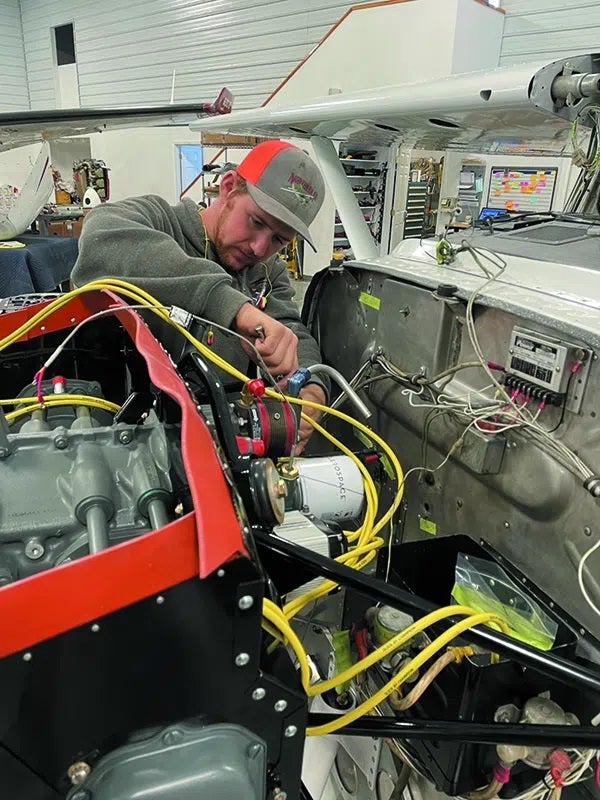

External Timing
External timing is performed with the mags on the engine and is ordinarily done at the annual inspection and during 100-hour inspections.
The process involves pulling a spark plug in the number-one cylinder and rotating the crankshaft until the number-one piston is at the firing position specified for that type engine—usually 20 to 24 degrees before TDC. The technician then uses an ignition timing light connected to the mag’s P-lead terminal while adjusting each mag by loosening its base clamps and rotating the mag on the mounting pad until the timing light indicates that the points are just beginning to open. The tech then tightens the clamps and checks the timing again because the mag may have moved.
We have seen damage done to engines when the magnetos were mistimed. Advancing the timing a few degrees more than called for by the manufacturer will cause the engine to run hotter and reduce the detonation margin. Timing advanced by just four or five degrees on a big-bore engine, combined with a hot day, has caused detonation on takeoff and engine destruction shortly after.
