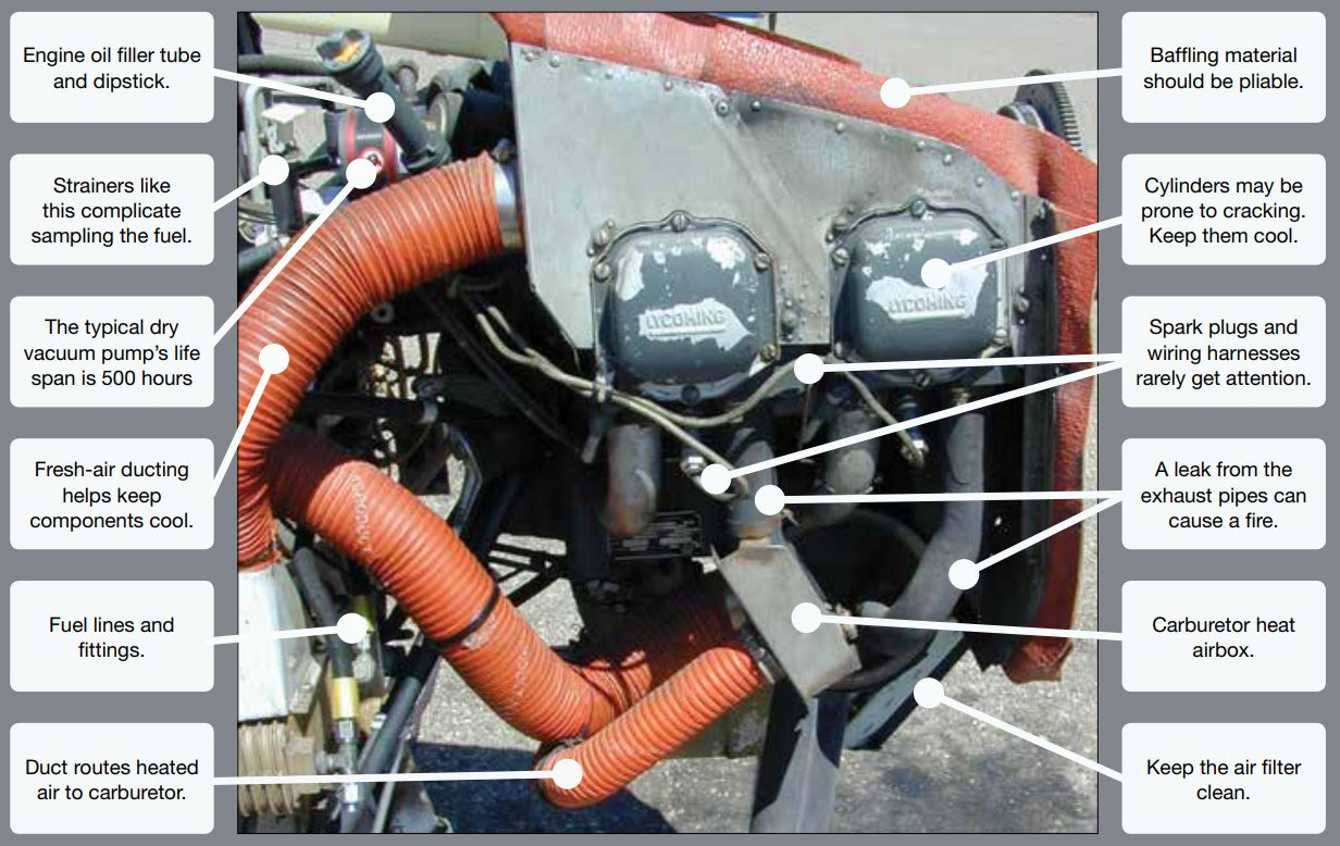

Components And Accessories
In addition to the crankcase and cylinders, modern aircraft piston engines incorporate numerous external components and accessories. These can include a fuel pump, a carburetor or fuel injection system, magnetos, a starter, at least one alternator, perhaps a propeller governor, a vacuum pump and more. Each can contribute to or cause an engine failure, or result in another kind of problem. These components are very important and need to be carefully checked and inspected at regular intervals.
Magnetos probably are the heart of an engine. Since there usually are two of them present, it seems unlikely both would fail at the same time. A 500-hour magneto inspection and adjustments are recommended for both Slick and Bendix magnetos.
Carburetors are another component that rarely causes a complete engine failure but do occasionally malfunction. Floats can sink or stick, and the throttle or mixture linkage can become disconnected, among other problems.. Water or other contaminates mixed with fuel can cause immediate engine failure. Moisture even in small amounts can damage a carburetor or fuel injection system with corrosion or contaminants, disrupting fuel flow to the engine.
Exhaust systems should be checked for cracks, leaks and signs of extreme heat. An important check is to look up the tailpipe, checking that internal baffles are not loose, cracked or missing as pieces of baffle or internal exhaust material can block the exhaust outlet causing a reduction in power.
Gear-driven starters, starter drives and gear-driven alternators all have been known to fail, causing metal chips to spread throughout the engine. If an engine starter does not operate properly, carefully check for internal engine damage after the starter drive unit—don’t just replace the starter. Belt-driven alternators are usually not a problem unless there is evidence of an out-of-balance condition or the drive belt and pulleys are not aligned properly.
Vacuum pumps, propeller governors and other accessories must be attached and torqued properly to provide for trouble-free operation. These components can indirectly cause an engine failure due to an oil leak from a loose oil line or improperly torqued mounting nuts. Minor details overlooked during inspections or even on a preflight can cause major problems once airborne, leading to a possible engine failure.
