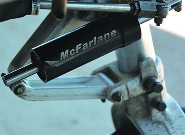

McFarlane Dampeners
When designing the McFarlane aftermarket dampener, Dave McFarlane and Ben Maples decided to re-create and improve the Cessna part by identifying its problems and redesigning it. They included things like a quad-ring seal, temperature- and altitude-compensating fluid orifices, a larger diameter piston rod and a new design that allows the fluid level to be checked without removing the component from the nosewheel. In its design, every weak area of the Cessna damper was addressed.
McFarlane developed its shimmy damper using a quad-ring technology, or an O-ring that has four sides, more surface area and does not spin or twist inside the cylinder. The company’s original prototype proved to them that the unit could undergo thousands of cycles (300,000-plus) without needing servicing, plus the dynamic tests revealed that the dampening started virtually immediately when a force is applied to the nosegear. The company makes all of the test specs available on its website at the end of their shimmy damper product page—it’s worth a read.
Benefits they had not expected included the absence of leaks throughout the test period, the lack of servicing needed for the fluid and the longevity of the part, even under accelerated testing protocols. Using hydraulics, the response on the ground feels immediate to the pilot; in fact, you have to be looking for any forces to realize they aren’t there—it’s that much of an improvement over the OEM. Visit www.mcfarlaneaviation.com.
