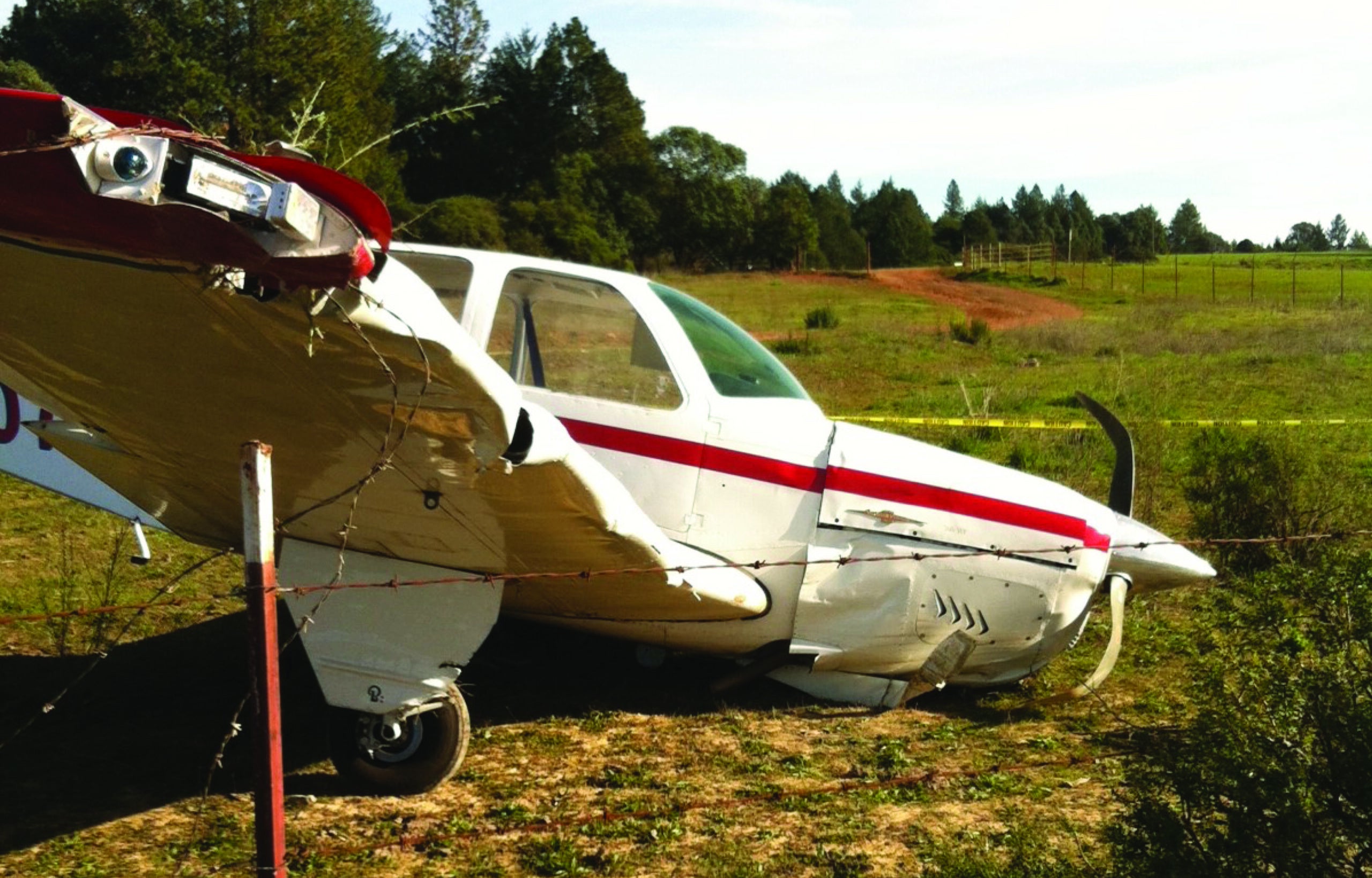

Avoiding crash injuries boils down to two goals: keeping the cabin as intact as possible and avoiding body contact with said cabin. How do we accomplish this? Reduce airspeed and maximize deceleration potential. Airspeed reduction mostly involves hitting the crash surface at the slowest possible airspeed. The Airplane Flying Handbook provides a powerful example of how critical each knot is.
Modern light airplanes are typically designed to provide protection for crash landings up to at least a 9G deceleration. The older the airplane, the less likely it meets this standard. In a perfect world, at 50 mph, a uniform 9G deceleration requires 9.4 feet. A 100 mph, 9G deceleration requires 37.6 feet. Perfect, uniform deceleration will be rare. That being said, it is worth noting that doubling the speed quadruples the distance needed to decelerate at a given rate.
Additionally, you can use your aircraft and the terrain around you to reduce your speed safely. Using the wings, landing gear and fuselage bottom to slow down will do no favors on getting the airplane flying again, but it will keep your seat and the metal around it as intact as possible. Fields with dense crops, vegetation and even trees can act in a similar manner as EMAS. This is where reducing airspeed meets maximizing deceleration potential. You can be flying a perfect emergency approach, slow as possible and into the wind, but if you come to a stop too quickly or cannot keep the airplane straight, the chance of injury increases. Just like in a car, you have the most protection in a head-on collision. For example, if you were to drive into a tree head-on at 20 mph in your car, you have the crumple zones and material in front of you to help dissipate energy. If you were to hit that same tree sideways, say with the driver’s door, the potential for injury rises.
